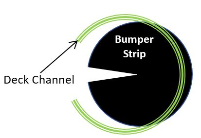

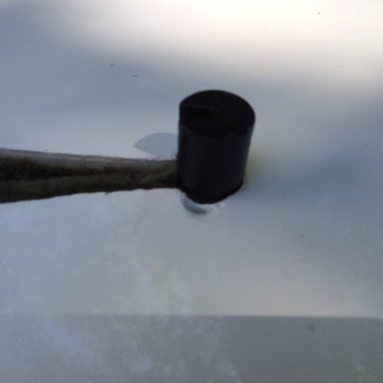

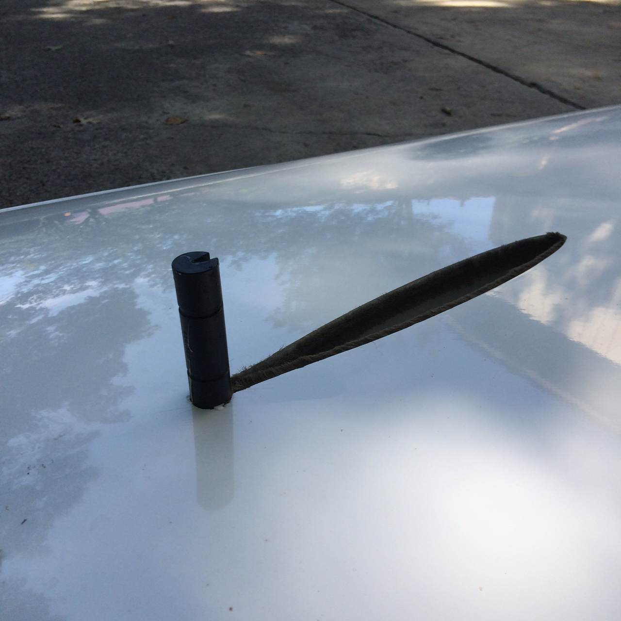

did not work in my case. About 20% of the fender strip was blocked by the lip at the bottom of the deck channel preventing it from moving into position, which sounds like what you are experiencing. In my case, tapping the plug downward was the only viable option and worked fine, although got a little tight near the end. It would help others if you could post a photo from the deck side showing how the strip is blocked from moving upward. Good luck.
