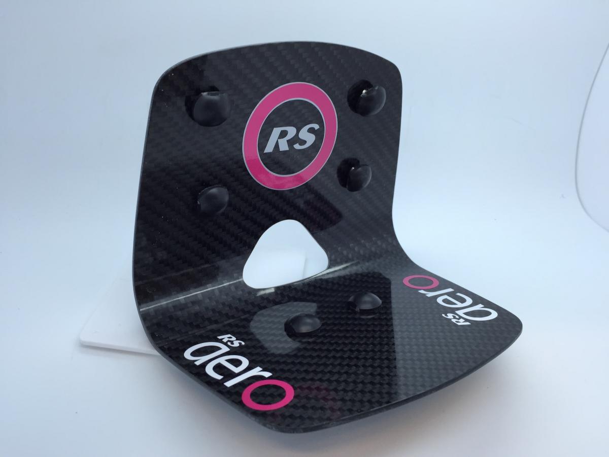

Peter’s advice is all good, but being klutzier than he is I find I need to tape it to ensure it stays square. If the conditions get rowdy, I seem to knock it at some point, and then no amount of friction tape or shim keeps it perfectly square.
12/08/2019 21:30:00
Posts: 2831
Hi Tsharks,
Sure, the Button Fix does allow the potential of rotation if knocked. Maybe two button fixes would have solved that, however, if unnecessary, that would go against the RS Aero's design ethos of simplicity, lightness and minimising cost.
It is a simple attachment on a smooth part of deck so you may chose to add tightness (by padding out the bottom of the compass) or adding friction (a little non slip tape maybe) to be more secure and firm..
I cope with just using the button and bracket as they come, but I am conscious to get it square and not knock it. On a multi day event I might go to the trouble of adding tape to ensue the compass stays square - but adding to the underside of the bracket would provide a tidier solution.

As a new owner of an Aero, I am revisiting this thread, not addressing a rule change, but looking further into the functionality of the current bracket. I can accept its location and thought process in design. However, its mounting function leaves very much to be desired. Using a " button-fix"  assembly which to me is designed for static panel attachment, is being used in a dynamic situation causing problems from the start.
Making certain I have the bracket fully engaged on the BF assy,  there is easy rotation in a dry fit and increases when sailing. I have added an edge molding to the bracket where I can, to provide friction and reduce any twist. It helps but is not a perfect fix.
In a training session, with a speed puck mounted to the bracket ($500 investment) I did a controlled jibe in waves and the bracket popped straight up at least 100mm before returning to the deck. Having a tether on the speed puck kept the assembly from sliding any further on the deck.
I am interested in knowing if there are any suggestions from Button-Fix or our sailors to make this assembly a more positive locking fit?
Duct Tape, Really?? Can't buy that one.

This was one of the topics considered very carefully when the boat was being designed. As you appreciate, a basic philosophy of the class is it’s strict one design; we also want to avoid any arms race on equipment. Therefore, re this class rule:
You are free to make your own (or buy from a third party) a compass mount. That mounting bracket must be affixed (screwed or glued) to the female attachment (Part number RSM-HF-903 on the RS Parts website for £1.43 +VAT) or an equivalent. The female part can also be found on Amazon or elsewhere online. It is cheap. There will be stocks available in Weymouth. If you have trouble finding one, contact customer services at RS or your local dealer.
During racing the female part must be connected to the button on the deck. This was originally designed so that the location allows the vang rope to go through a hole in the mount, which saves the compass from going over the side if it comes loose). Merely tying a piece of rope to the button, or taping it to the deck or some other arrangement is not Class Rules compliant.
We are grateful for letting us know your concerns about the current location of the button and have raised it with RS. We will do some more research and talk to various people at the Worlds in Weymouth to see whether the button location should be moved forward. In the meantime, for Weymouth only, if you want to make a plate (a bit like Laser sailors use) attached at one end to the button and extending forward toward the mast (with the forward end being taped to the deck) we will allow this.

I like my standard RS Aero compass bracket. It is nicely designed and works well with my Tacktick micro compass. It is secured by the kicker/vang line and in the latest version of the class rules it has been clarified/permitted that any chance of movement can be removed by some tape or a little velcro stuck to the deck.

I also agree that the RS-supplied bracket is overpriced for what you get, and is not very resistant to rotating inadvertently.

This is a request to remove from RS Aero Class Rule C.5.1(a) the following:
"; the mounting bracket for the compass shall attach to the Originally Supplied bayonet attachment located between the mast and vang cleat"
The stock RS Aero compass mounting point has two big issues. It: 1) does not sufficiently secure the optional (and very expensive) manufacturer-supplied mounting bracket; 2) is too far back to effectively use a flat/single-display digital compass when sailing upwind due to off-axis viewing issues (virtually necessitating the use of the expensive, dual-display tacktick compass).
Even the Laser class, a notoriously restrictive one, permits mounting of a compass anywhere on deck, as long as the hull is not pierced. Does it not make sense to allow RS Aero sailors to do the same?
