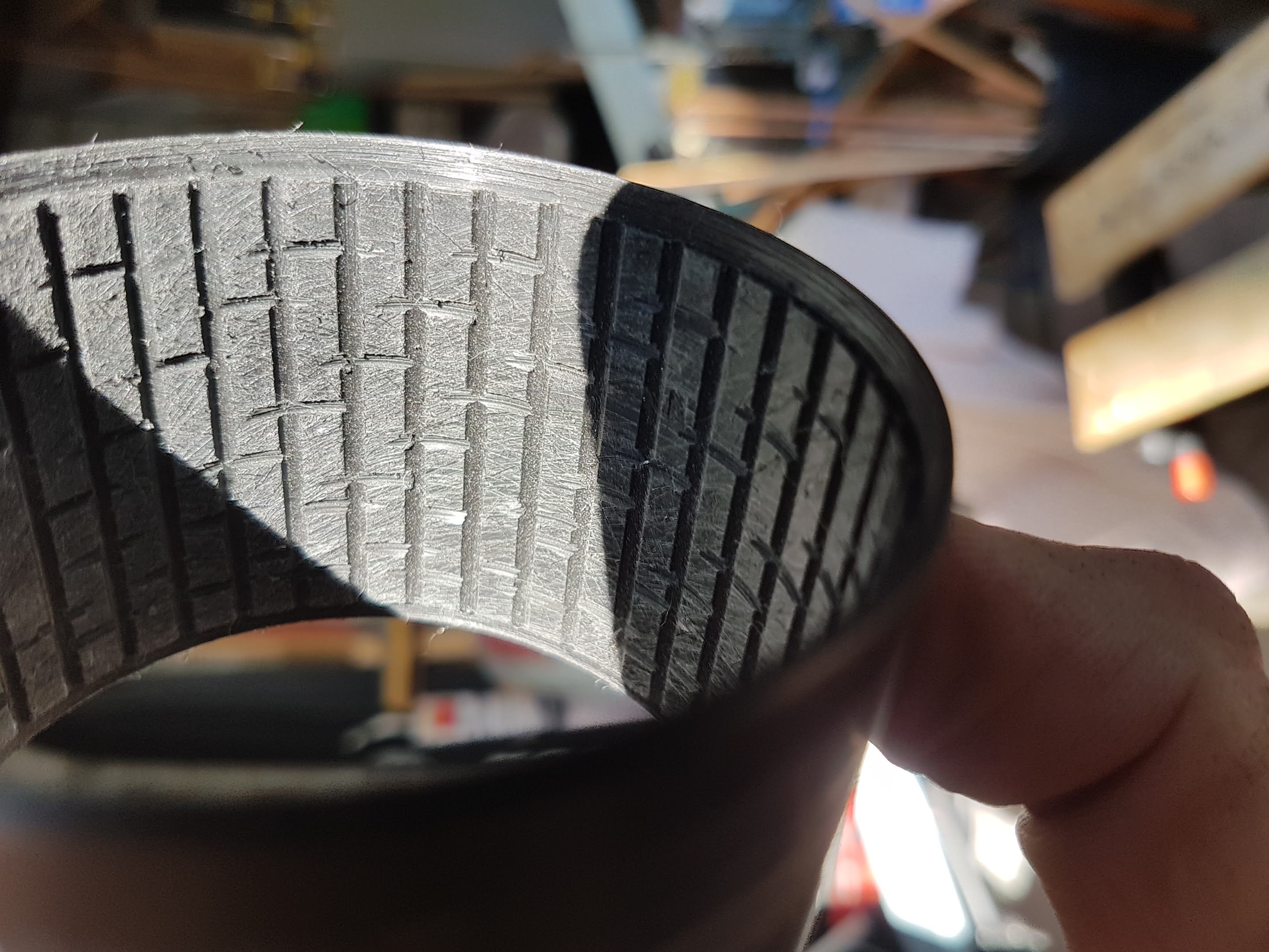

- cut additional horizontal slots inside the collar using a Dremel tool cutting wheel (I used two wheels doubled together, and made a nice pattern, partly because I like patterns, and also to avoid lining up any of my slots next to other lest I create a stress fracture pattern.  If you don't have a Dremel tool or but a cheap equivalent, ask a friend, or a even maybe a local model maker or jeweller, or choose to skip this step completely as possible overkill);
- lightly keyed the inside of the collar, including the recessed rims with 60 grit sandpaper;
- removed loose burrs with a wire brush; and
- cleaned again.
 NOTE: If you've left the mast collar loose and rotating for too long, you might have worn away the inner surface and need to purchase a new replacement collar so that the collar is a tight and not a floppy fit which will be difficult to centre on the mast (I tried that once, it's not worth the effort).

And this is the collar after I cleaned it, keyed and roughed it up (details in next reply):

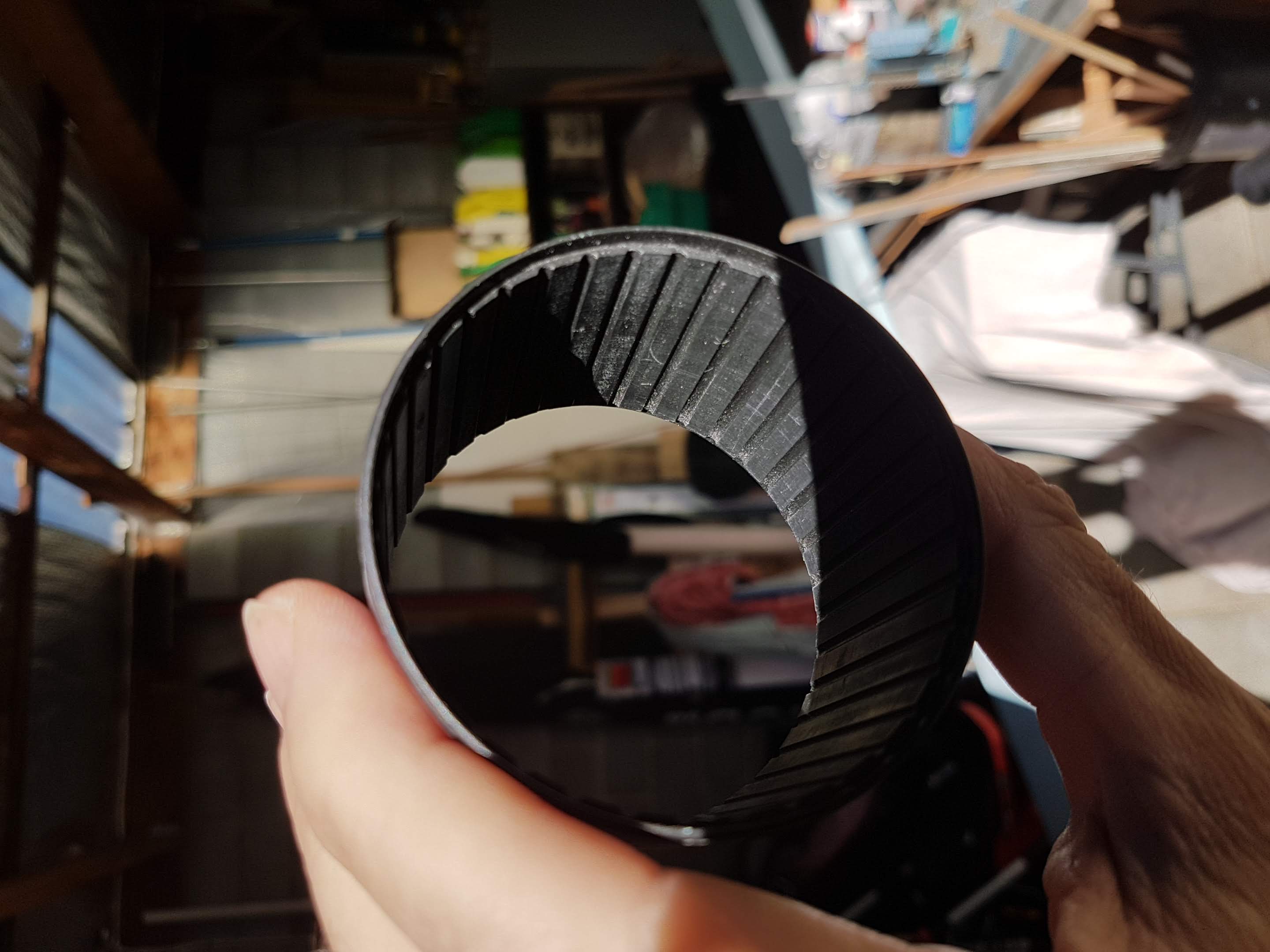

This is Collar after I first removed it, note that it is relatively smooth inside apart from the pre-formed longitudinal grooves:

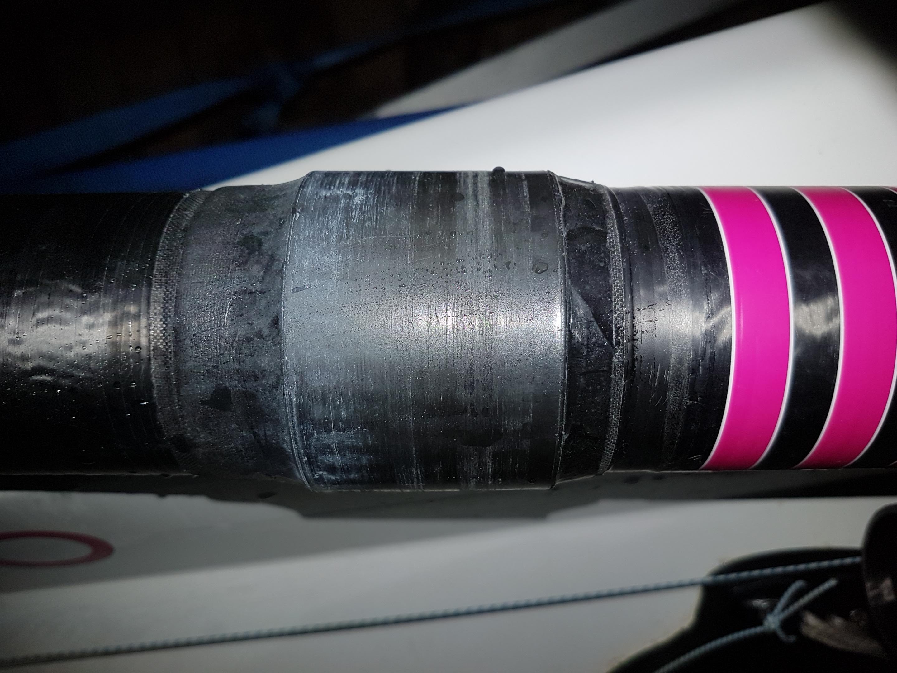

This is collar after repair:

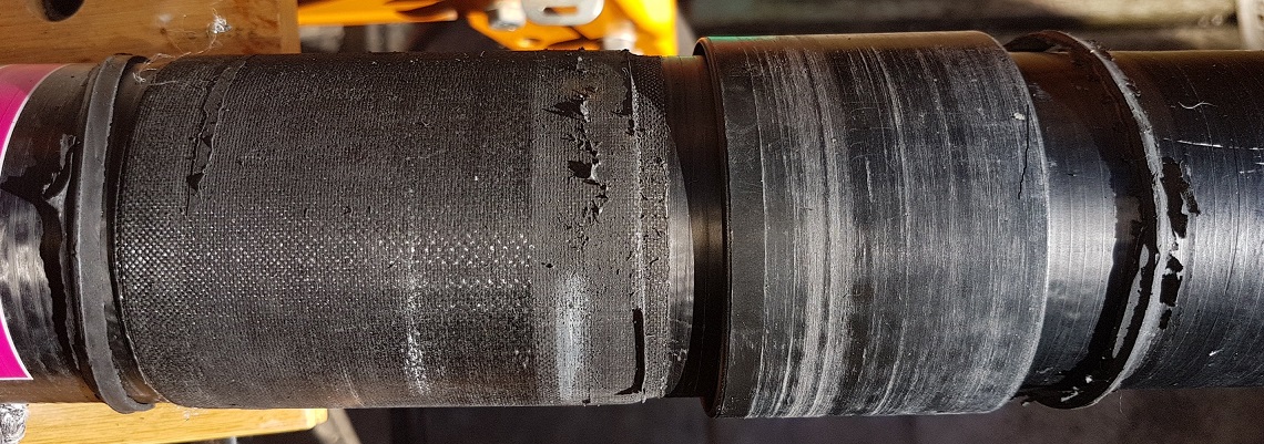

Hi Mark, this is what my collar looked like before repair:
