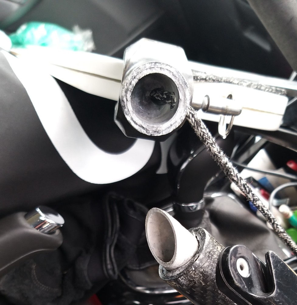

Hi Junior,
My tiller snapped off yesterday. Please would you identify which modification Mark this was from the attached picture. Mk1, Mk2, Mk3 or Mk4?

Thanks Junior for explaining the rudder/tiller issues and the efforts RS has made to correct the problems. I wonder if the anti galvanic paste used in assembly tends to break down over time? The tillers I've seen fail also show corrosion of the aluminum casting where the carbon meets the metal.

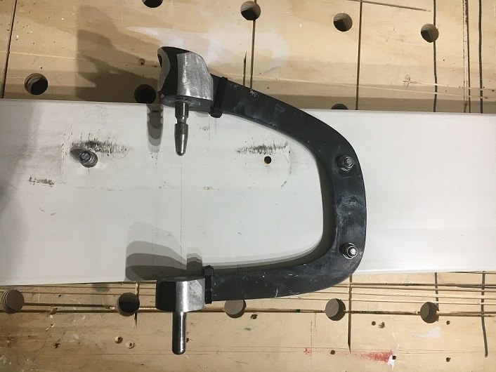

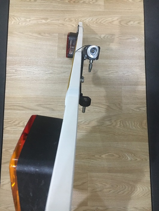

One "positive" from the tiller stock breaking (as mine did exactly as described before Christmas) is I used my curfew time last week to adapt it into a perfectly fitting light-board pintel mounting for towing...

This has happened to me as well (as you witnessed!). I’m told that the newer ones are improved, but I don’t know what was changed. Does anyone have any information on how the new ones are different?

Here in Palm Beach, FL, we have had two carbon tillers break inside the aluminum rudder housing in one week. It's understood that carbon fiber in contact with aluminum results in a galvanic reaction so what we have seen is the aluminum is corroding and the carbon is weakening causing the tiller to fracture inside the housing and there is no way to repair this, just purchase an entire new rudder housing with the tiller installed. These are five year old boats, well looked after.
Has RS addressed this problem? Fiberglass is an insulating material and I would suggest wrapping the part of the tiller which fits into the rudder with two layers of glass cloth to act as an insulator between the carbon and the aluminum
This might require reducing the diameter of the carbon tiller by a small amount in this area but it would be negligible and not reduce strength. Any other suggestions or do we all face this problem after a few years of use?
