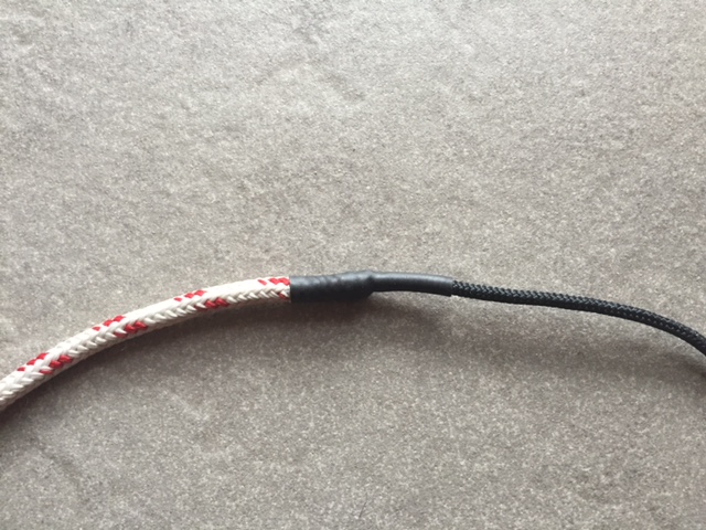

I did my own from Marlow Excel Racing 5mm , stripped tapered and works like a charm now. I cannot stand the "bumpy" transition. After my third day out, I knew it was needed.
Yes, it is a bit more expensive, but for $90 you get all good said and done with years of good use.
Really don't mind a $90 investment on a $7,500 boat when I know is going to last years, it is going to be light, no chafing on the spars or hardware, does not absorb water and it will be reliable.
Here is the before and after:
