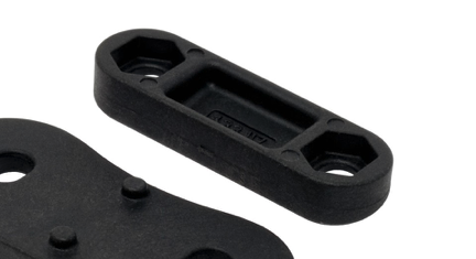

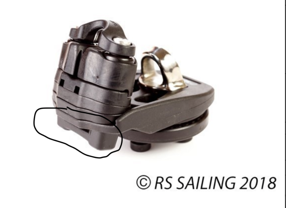

So - the problem was basically that the bolt were stripping out ot the plastic fitting at the bottom of the cam cleat stack (circled in the picture) - I replaced this with a plastic part from the wedge set which has hexagonal holes for lock nuts - replaced the bolts with longer ones, added some M5 lock nuts and tightened it all up - much better solution than the original metal into plastic set up

We've had a different problem with the kicker swivel cleat - it failed under load! We replaced it and it failed again! The load just pulled the bolts from the plastic backing plate - anyone else seen this?
