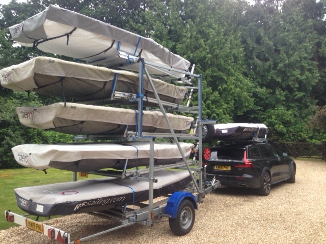

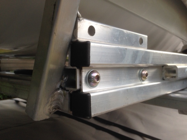

It is worth noting that for some time now, since 2017 I think, RS Aero standard trolleys have been supplied with two choices of adjustable height of the under gunwale supports.
From new they are supplied in the higher setting. This is most comonly preferered and allows ample transom clearance.
By moving the bolts in the frame to the alternative holes you can select the lower option to lower the gunwale suppots by about 70mm. Whilst you then need to be more careful of the transom this can have the advantage of keeping your feet drier in the winter by launching into shallower water and a more compact travelling height when limited on height or to reduce windage - and also helps to squeeze into the Eurotunnel trains if you have a 5 RS Aero high trailer!
Photos;
1. The two sets of holes give two height options of about 70mm difference
2. The top boat is in high mode but low mode would have given a little more leeway on the Eurotunnel train!
3. The low setting gives a more compact unit for transport, for limited space or reduced windage. This photo is the original trolley with lower height.
