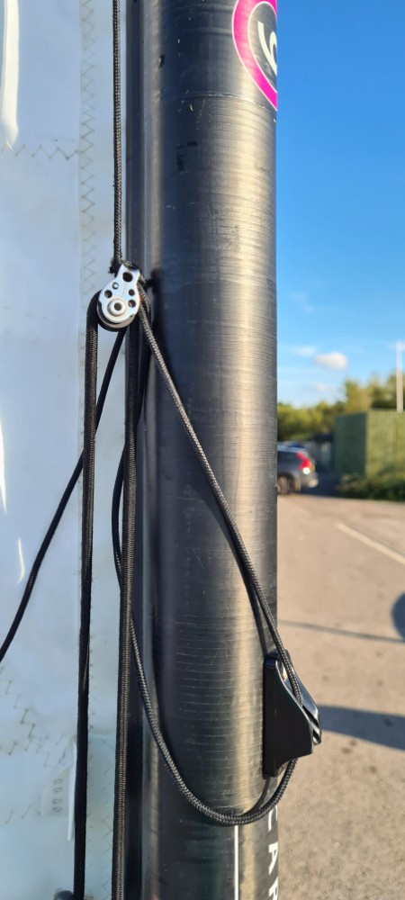

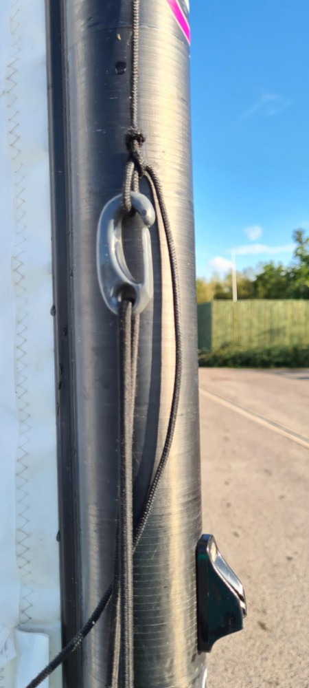

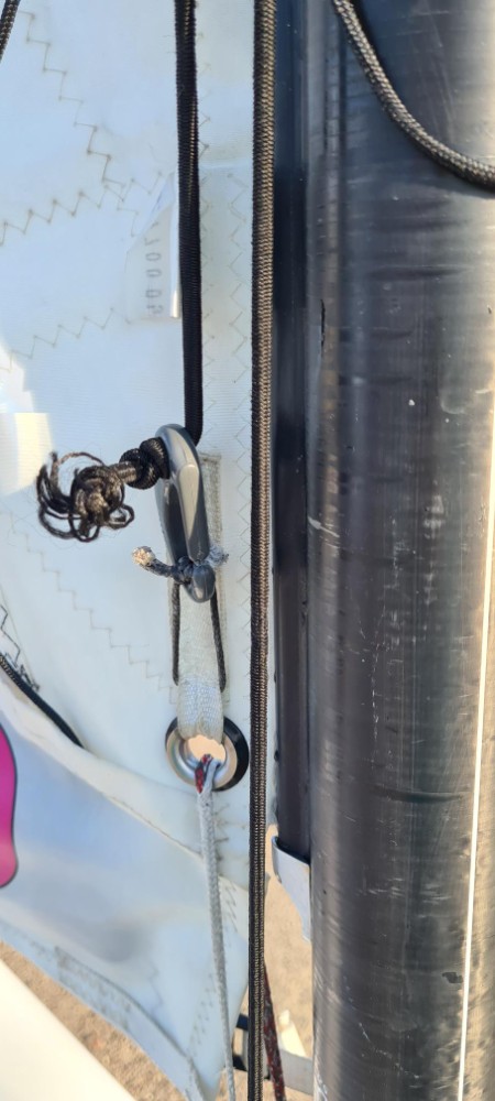

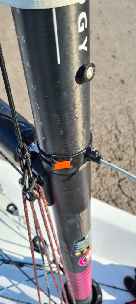

Thanks for the pictures.  I am sorry but your proposal is not within the Class Rules and is not in accordance with the Rigging Mannual. You are not permitted to put anything through the Cunningham cringle of the sail except the primary cunningham line.
The reason for not permitting this is that it is open to abuse.  You may be aware that some classes, like the OK, Finn etc allow inhauls at tack and cunningham points.  These can affect the luff shape of the sail.  This is not something that we want to risk occuring.
The phylosophy of the Designer and Class has always been to keep things simple.
Sorry
Happy sailing
David

Photo's attached. If the small string loop is not allowed plan would be to use a small toggle to pass through the eyelet instead of the (preferred) clip. I can't see why the proposed arrangement is any less legal than the current usage which has been common for years.
