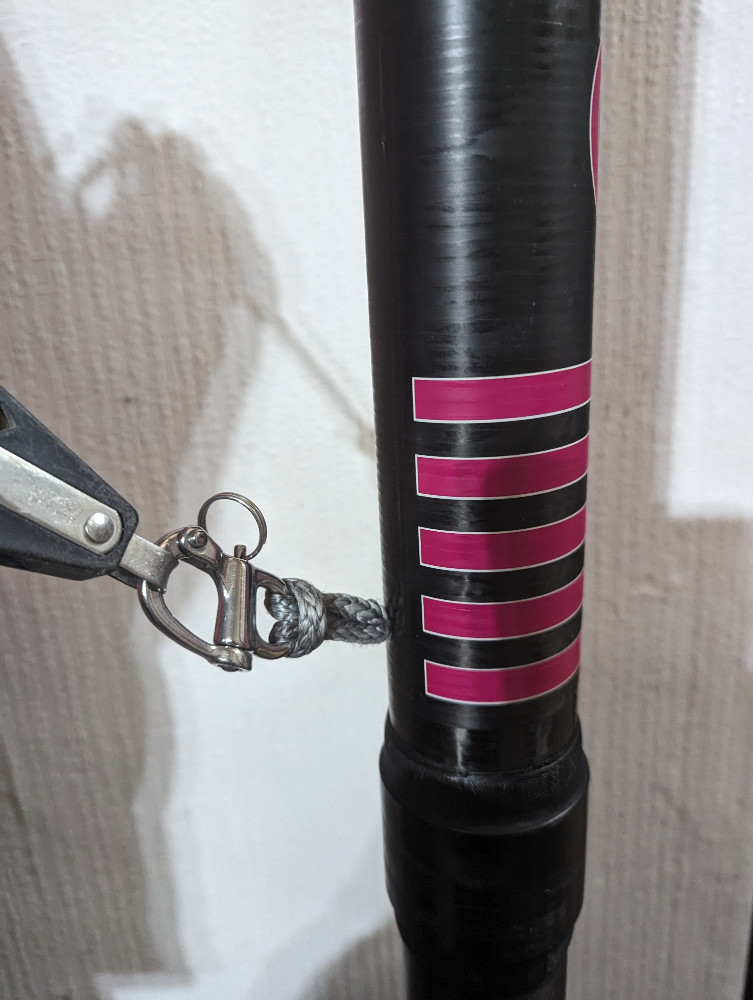

I have two replacement hips. When I go sailing I need to choose carefully the appropriate sail. Un-treading the vang tail and re-threading it to the new lower mast is a pain and it is easy to get something wrong. Jacques Garrigues’s fast vang de-rigger has it attractions.
I am looking at using some sort of soft shackle which hopefully will meet class rules. If I get it to work I will post details.
 When I return to shore I like to release the clew quickly from the boom. This reduces the risk of the Aero being blown over. I use a snap shackle to connect the vang to the bottom of the mast - very quick to release. Photo attached. (the block is not the block on my Aero)

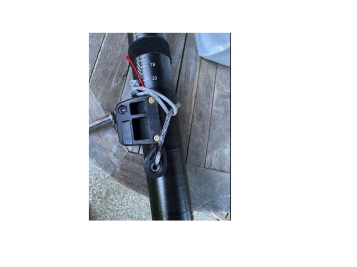

According to Peter Barton my "fast vang de-rigger" is not legal on 2 accounts, first my 30 mm block can only be 20 mm and second, that 20 mm block needs to be tied off of the gooseneck vang sheave. My setup only goes around the mast and doesn't involve the sheave. What I am showing is a block with a spliced dynema rope that has a loop at the other end, then a soft attach shackle passes through this loop so that the vang line can be disconnected from the mast. After undoing the metal mast butt vang shackle, the vang and it's tail handle can remain attached to the boom, lay on the deck, and the mast can be swapped out. I am trying a new version which passes through the gooseneck sheave and should be legal. Anyt suggestions would be worth discussing.

From Jacques Garrigues;
I would like to know if my new "quick release vang" setup is or could be class legal.
It will replace the use of the mast mounted sheave and makes derigging much easier and quicker.
My example uses a 30mm block which is superior to the 20 mm used in the RS Aero  mast, however a 20mm block could be used in my quick release too.
Also a significant part of my setup is that there are no metal shackles to deal with.
This idea has been used successfully on the Laser as well.
