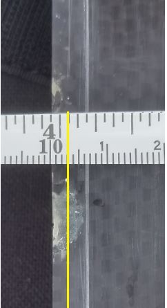

David,
I had several dings in the trailing edge of my centerboard that were repaired with thickened epoxy then faired back to the original chord width and profile.
One of the dings extended about 5 to 6 mm from the edge. See attached photo. My reading of Rule C.8.1(g) limits repairs to 3 mm from the trailing edge.
This seems overly restrictive for a repair. Am I missing something?
Thanks,
Mike Johnson
10/09/2019 22:44:00
Hi Dave
Thanks for your query.   This is answered in C8.1(h) "It is not permitted to vary the designed chord width, profile or shape of either the rudder or the daggerboard from that Originally Supplied.", see also C6.1.5. This rule was included to allow removal of any imperfections occuring during the molding, for example any projection on the center line.  However, RS produce such a high quality product that the rudder and centerboard rarely have these imperfections.  That rule therefore rarely has any use.
