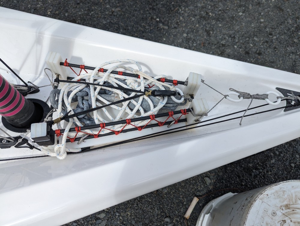

Obviously this is not going to be the optimal solution for many of you....BUT--I'm launching by myself from a rocky shore in salt water with significant tides. I worked with the mini-mooring concept for awhile, thought long and hard about gunwhale padding, but finally bit the bullet and rigged an anchor for my Aero (see photo). I'ts a 5 pound grapple style hook with retractable flukes, 20 inches of chain, and a couple fathoms of line. Holds the boat just fine in the condtions I sail in. The easily removable cradle is made from UHMW plastic, a bit of stainless steel hardware, and nylon twine. I rig my boat on the trolley ashore, then drop the sail, launch, and set the anchor in a few feet of water. Bottom is just too rocky around here (Kodiak, Alaska) to feel comfortable with shallow water capsizes. Then I can stow the trolley safely above the tide line, wade back out, hoist sail, stow the anchor, and get underway. Also makes shore stops along the way a lot more practical. Did I mention the capsize-proof shock cord keeper for the anchor gear? Also, I protected the deck under the anchor cradle with clear anti-chafing tape. This solution has made launch and recovery easier for me and easier on my Aero....

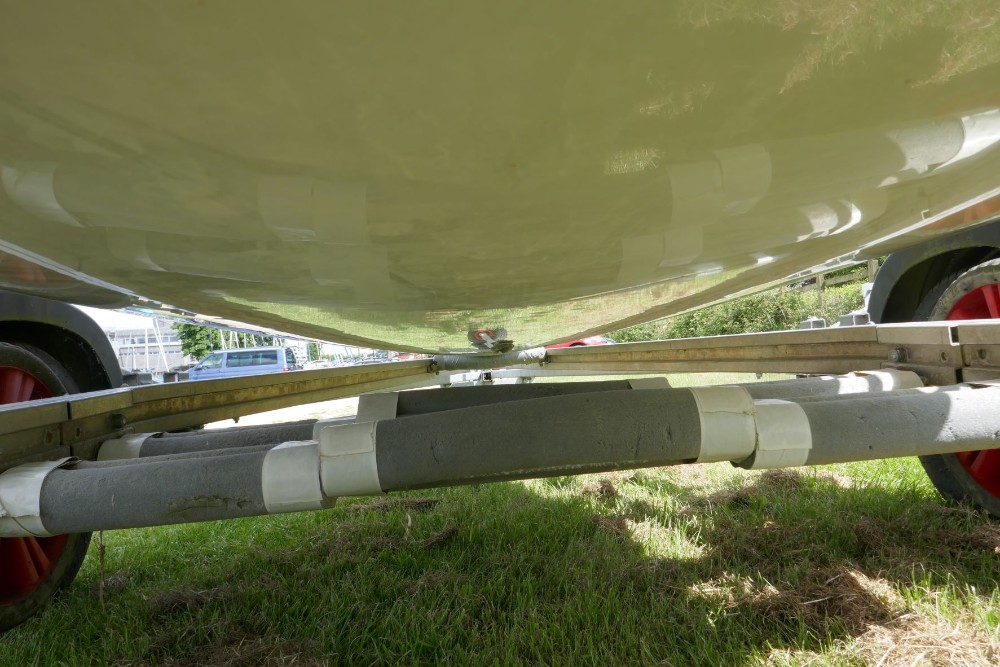

Capsizing the boat on it's trolley is not good either.  Though not always avoidable.  There are a number of protrusions in the trolley framing & arms that can scratch, gouge even, the hull.  It is worth considering padding over these.  I have used pipe insulation & Duck, Gorillar, Gaffer Tape to mgood effect.
The following shows what I did after having paid £xxx, that's hundreds, to have the hull bottom faired after multiple minor launch recovery mishaps.  The boat is a 2014 vintage Aero, so in it's eigth year, and was faired 2016, so 6 years since.  There are two scratches from a recent this year capsize on recovery, a 90 deg wind shift with sail still up, and that is all!!

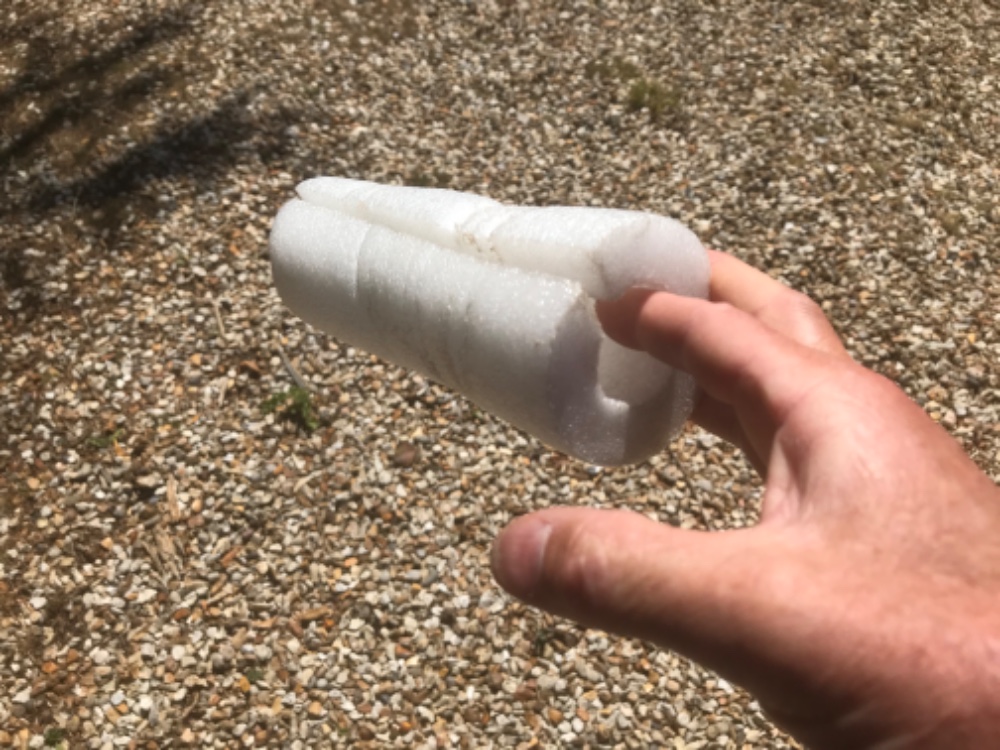

Hi Gregg,
I have never done this but I have thought about it in case of an opportunity for a picnic, pub stop or adventure....
I think some thick pipe lagging/insulation (maybe 50mm diameter similar to image) could be good as the slit side could grip the gunwale and stay in place whilst carrying on its side with. A short length front and rear of the wide part of the RS Aero would work.
Alternatively you could carry a mat or sheet.
