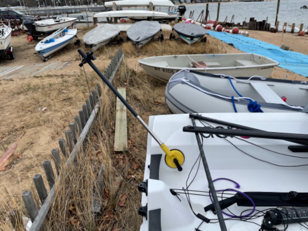

using my DIY selfie stick with the 1/2 glass suction handle...

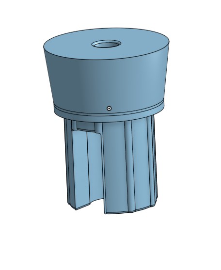

 Hi
Mast top mount was just pushed into the top of the mast.
I put small ribs for an interference fit
The slot is to fit around the back of the nuts and bolts holding on the halyard, this stops it twisting
I started making the mount bigger and stronger but then realised I wanted to make sure the mount broke before the mast.
I run a safety line from the camera around the halyard eye so I dont lose the camera when the mount breaks

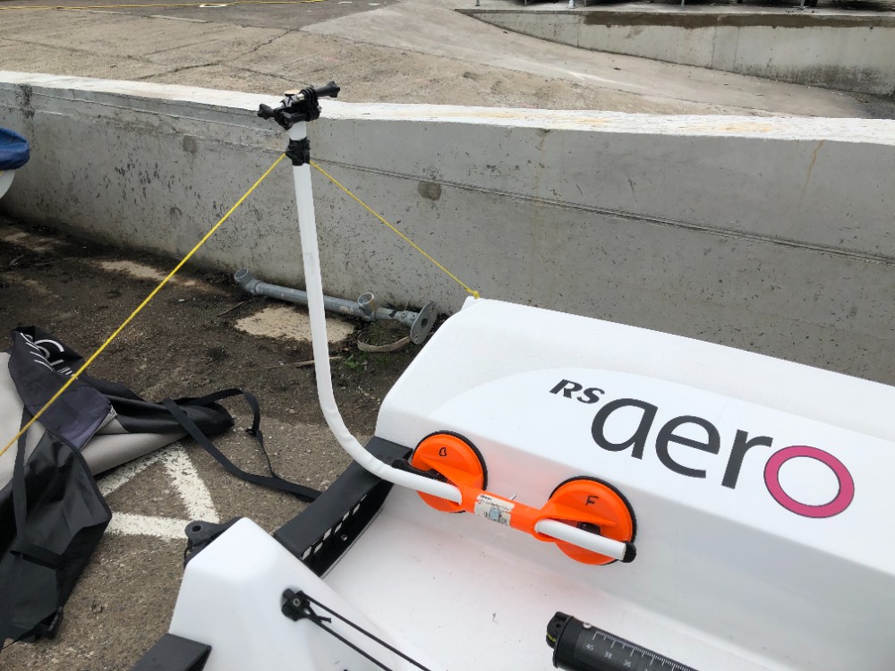

I cut the glass holder in half and stuck a pole in it a put a bolt to hold the pole and a line to the camera base in case the whole thing comes in a capsize. It works. But what I don't like is view is different depending on which tack I am on. I would prefer the camera in the middle.

Here is another thought.  20mm electrical conduit - bent using a heat gun.  The suction mount is for handling glass and is from Screwfix for around £7.00.  Stuck a piece of wooden dowel in the end so the camera mount would not crush the pipe.  Two small pieces of string to the hole in the end of the gunnel keep it steady.  Suction cups have to be attached first then the pipe is slid through and a bolt with a wing nut secures it.  Works!

18/04/2022 21:52:00
Posts: 14
This is not the final version. It is fixed only with elastics, so that the rudder can be moved completely.
It will look nicer on the top and every camera can bei mounted and gives a picture from the back of the boat.
