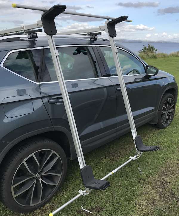

The product
This is a very robust roof lift system made from substantial aluminium extrusions. It can take over 100kg which is probably in excess of the roof load limits of many cars. I forgot to take a picture of the package as shipped, but only final assembly to your car roof is required. Here's a pic of it on my car, rack system extended.
The 2  rails come assembled and comprise a rigid ally track and rollers. When extended as shown 2 substantial brackets hold the extended frame at an angle and prevent contact with the car. You can adjust the height and distance to suit your vehicle. When retracted the slides are secured by 2 large spring loaded pins, I can't see them giving way during a motorway drive.
 The rack attaches to standard roof bars, Karitek have a range of clamps to suit most cars and rack types.
 Assembly
 Allow 1-2 hours to put the rack system together. There is not much to do, but you will need to measure up your roof bars and the centres of the racks to get everything aligned. I found it easiest to put my roof bars on first and measure the centres, most cars will have different widths front & back. Then it is a matter of measuring the centres of the roof system racks and attaching them to the roof bars, I marked them 'front' and 'rear' for future reference. It was easier to assemble everything with the roof bars off the car, and then attach the whole assembly to the car. As it is all aluminium weight is not an issue and they are not that unwieldly. Finally you will need to attach the brackets and cross bars which lock everything together and make a nice rigid package.
 Taking the system off the roof is now a matter of minutes, take the bracket/cross bar assemblies off first, just 4 bolts to undo, and then remove the roof bars & rails assemblies. Putting it back on is just the reverse so you do not need to drive around with a lot of drag on your roof between transporting your dinghy.

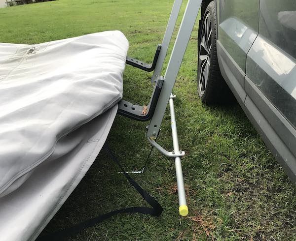

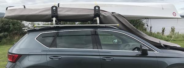

 This is the easy bit ! I ease my Aero off its trolley and let the gunwale rest on the bracket as shown. The brackets are tough plastic and thick foam so there is no risk of damage.
 Getting the CofG right is important, I position the front support about the point where the hull starts to taper to the bow. Next lift the opposite side and the Aero easily rotates over the vertical to rest in the supports. The rack is rigid so this works very well, the end result is as per this image.
 I use 2 elastic rack straps just to hold the Aero in place, although it is very stable.
At this point I place the spars under the hull onto the rack, although there is room for them on the side and in the future I will probably clip the spars in place before the lifting the hull on.

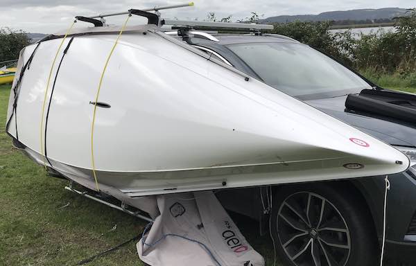

To complete the operation lift the lower bar to waist height, you are only lifting half the weight, it is very easy. Once at waist height start to walk the frame towards the car, it rolls along the fixed rack very smoothly and is rigid enough not to want to twist and jam. At this point the rack system is doing the lifting, you just push until the Aero is about half on and then gravity takes over and the rack/aero drops onto the rails to be slid and locked in place as shown in this image.
I was time limited when taking images which is why the cover was not properly secured ! Getting the Aero off is just the reverse, no huffing and puffing and no arm/back strain. I expected the system to work well, but was surprised at how easy & speedy it proved, no comparison with the lengthy and sweaty method of pushing the Aero over the back of the car.
