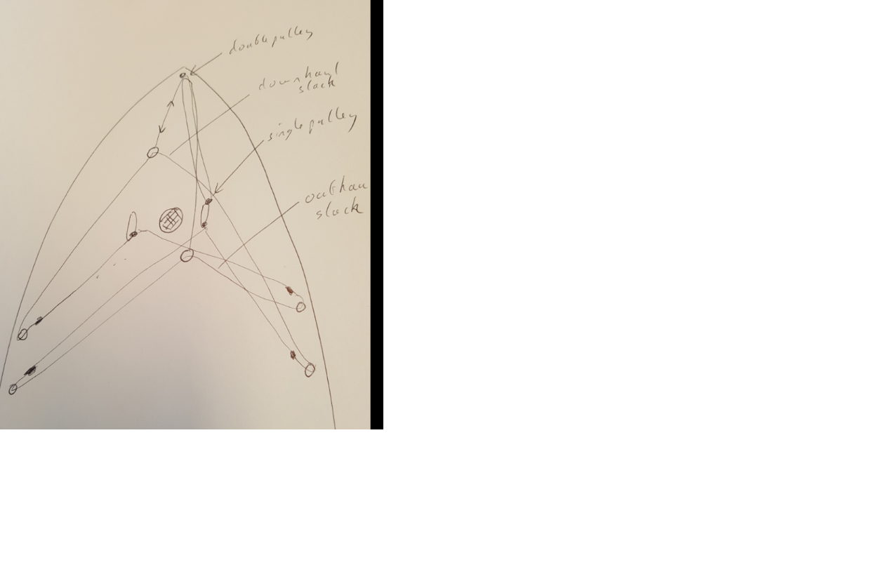

Two continuous ropes. One for downhaul, one for outhaul. The downhaul needs to have more length of adjustment which is why that one goes right to the bow. The outhaul only needs a few inches of adjustment so stays behind the mast to use less rope and keep it away from the downhaul. A few of us at Island Barn are experimenting with this (and credit Matt Thursfield who started me down this route). I'll try to get some pictures in a couple of weeks.

Hi Gareth - thanks for the description and diagram - much appreciated. Keeping all the elastic and slack up the front and out the way makes sense to me. If I'm reading the diagram correctly you have used one continuous line for downhaul and outhaul? That's a very cunning plan!

Don't have pics but will do them in due course, but I will describe it. (I'm away for a couple of weekends). I have two double pulleys one tied to bow top fitting, one to the fittings by the mast. I then take a long thin elastic start with plastic ring then elastic goes  through pulley at bow up and down through the double pulleys (that's just to get enough length in the elastic to give enough stretch at low tension) ending with another plastic ring. Instead of leading the rope through the deck I have a line between the two deck holes with a ring on each end so there is a plastic ring on top of the deck hole.  So now we have rings on the deck where the ropes would have gone through the deck, and two rings attached to thin elastic at the front of the boat.  Lead the ropes through the rings, using the ones at the front to take slack out (one at the front for the downhaul, and one for the outhaul).  It takes a bit of playing with the lengths of rope and elastic.
Rough diagram uploaded. Hope this helps.
