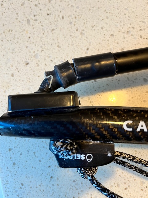

Hi,
The outer skin of the tiller extension universal joint seems to have failed. Is this just cosmetic (the underlying joint seems fine) or does it need replaced? I don't want a catastrophic failure while sailing so I'm guessing it needs replaced.
Grateful for any advice.
Thanks

I would suggest to replace it. If it breaks it is quite difficult to sail upwind.
You can use special replacement, where a cord is insinde. This helps a lot in case, the rubber breaks (what will happen from time to time)
https://www.roostersailing.com/products/128052
I am not sure, if you need to adapt this, I bought one here in Germany, which fitted 1:1 in the original hinge.
