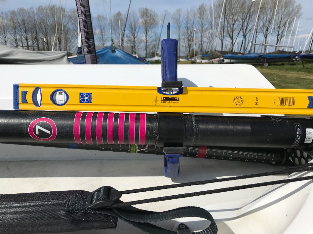

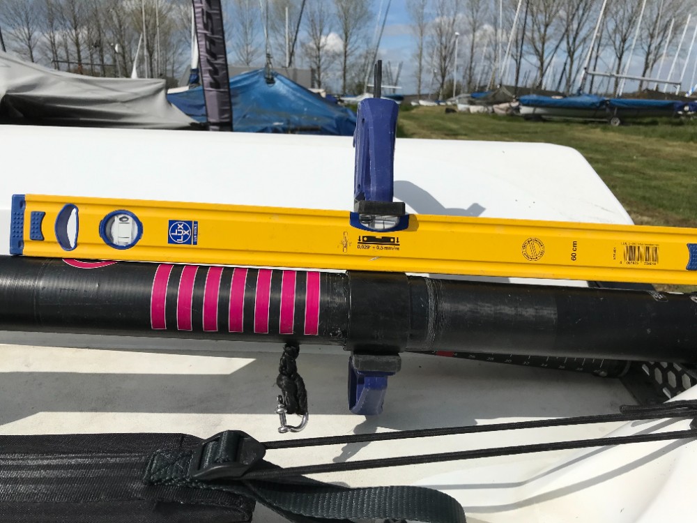

End November last year I had both my 7 & 9 mast collars come loose, start swivelling.
Cause was the raised deck ring wearing such that the collars were bearing part on on the deck ring & part on the mast tube gel coat & laminate, 1141 is a 'white collar' ie pre recessed deck ring boat, 2014 vintage.
Deck Ring replaced, and the two mast collars.  Collar kits had an Araldite slow cure, 24 Hrs, Epoxy adhesive; not the Sikaflex referred to in the instructions, and used on the failed collars.
The 7 mast Collar was just pushed up over the boss on the mast and is not quite aligned to the mast; it's only a degree or two out in both fore -aft & port - stbd planes; but it jerks & makes loud creaking noises when sailing upwind on port tack & playing the mainsheet.  The stronger the wind the louder the noise.
the 9 collar was pushed on with a fine helical screw thread motion, and is better aligned, but it too makes some noise when rotating; albeit a lot less.
Both now seem to be wearing rapidly.  Both are scored, as is the deck ring.  And this after only a couple of months use.
Has anyone else expereinced similar?
Is collar failure and periodic deck ring replacement confined to or more prevalent on the earlier 'white collar' pre recessed deck ring, June 2015(?)  boats?
Or is it also a facet of recessed deck ring boats?
UK RS afterSales hadn't seen a similar case before, but have concluded it should ease itself out in time.
I supect this may have been the case if Sikaflex had been used, but suspect Araldite Epoxy sets too hard to have any give in it to align on use.
Is it feasible to break the joint & re-make, say with a new collar?

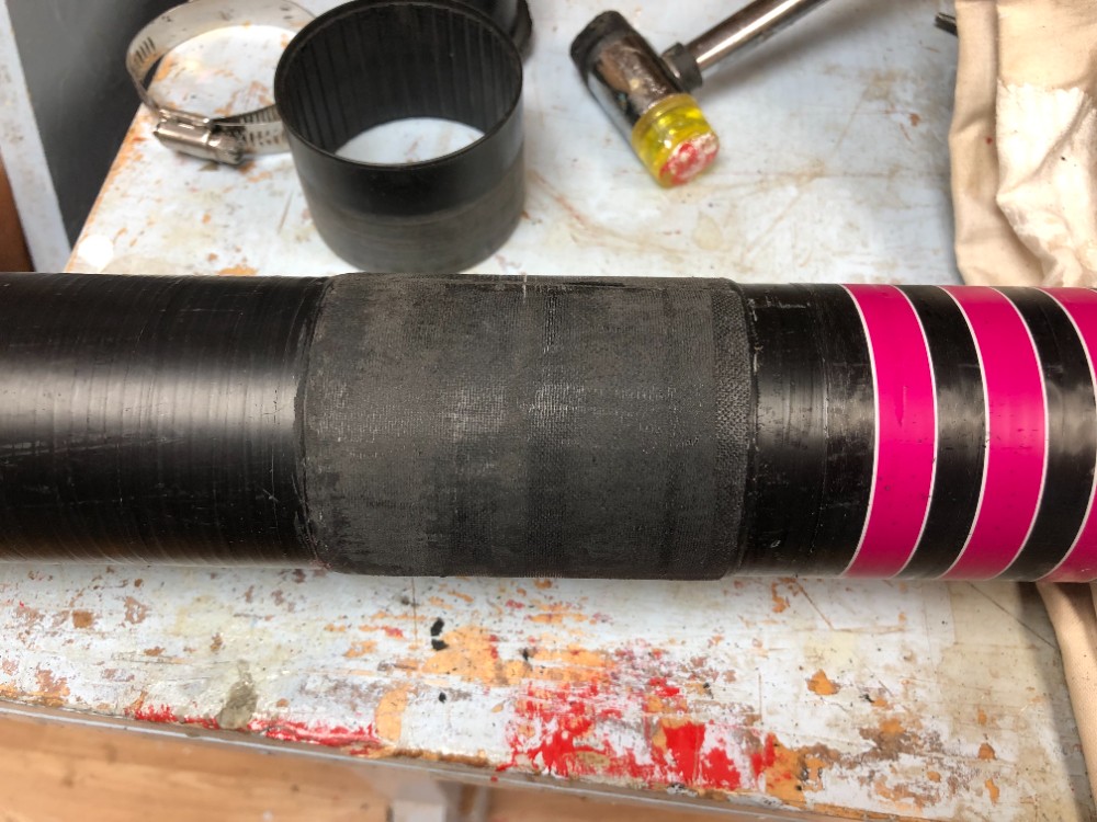

That looks right. Just need to measure to get the right position (see the RS instructions) and, as you say, rough the surface before applying the epoxy.
Dave

The mast collar has been floating about for the last couple of weeks but only noticed when racing on Sunday so time to fix it - Thanks Hairsy - the trick with the jubilee clip worked a treat to remove the mast foot undamaged.  I have removed the rubbery type substance that was either side of the collar but now looking at the mast - does this slightly thicker material need removed?  Mast is around 62mm diameter and at the mast collar area it is around 64.4mm diameter.  Does this have to be brought down to 62mm or just roughened up?
