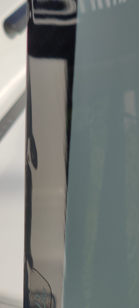

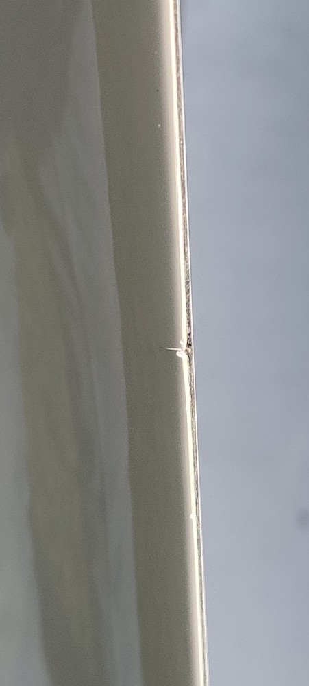

Also, my foils at the leading edge have quite uneven bond gaps. At some points the gelcoat joins without gaps and at other points there is a 1-2mm gap.

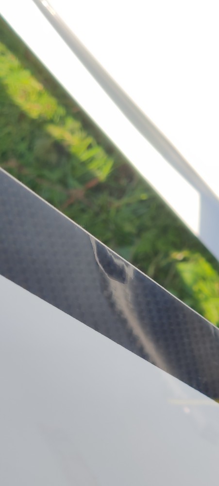

Today I went out in 20knot winds, and it was very evident that my rudder was vibrating. I also think a little bit on the daggerboard but adjusting doesn't cause much change.
Before I went out I discovered some imperfections and the corner edge was not bonded correctly. Looks like bubbling is also occuring and tapping in certain places sounds almost hollow (air pockets?)

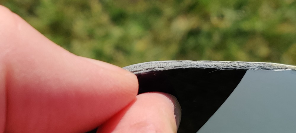

A bit more data: My 3414 centerboard and rudder did not have any asymmetric bevel when delivered. It was rounded and looked like it just had a bit of sandpaper run over the trailing edge. My first Aero 1250 centerboard had a very marked asymmetric bevel. The second Aero 2500 had a bevel too, but less. The 3414 boat eliminated the bevel completely.
However, I've since put a 3mm 30 degree bevel on both foils and the problem while reduced a little, is still there.  I took great care and made a jig to achieve a very even, 3mm bevel at a constant angle. I'm reluctant to increase the bevel beyond 3mm and would need advice from RS that this is required.

Both RS Aero foil trailing edges' are built asymetricly to avoid hum.
I suggest you check the trailing edge of your daggerboard to see if it is asymetric like your last one, or not.

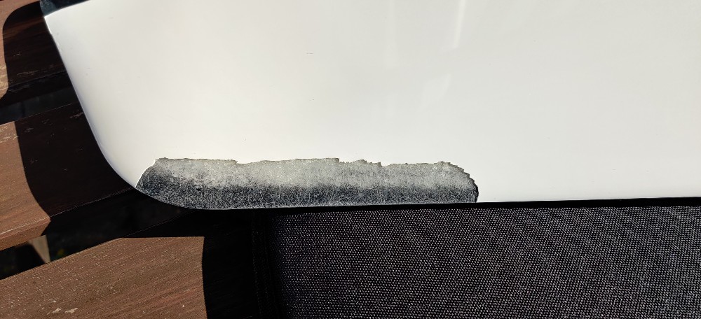

Recently traded in RS Aero, upon receipt of new boat the build quality hasn't been great. The first hull had to be replaced due to imperfections. However RS where great in facilitating this so due credit there - life happens and things do go wrong.
On the maiden voyage, after the replacement, last Monday. I noticed a strange hum (super excessive) The daggerboard delaminated and gel coat pealed back. RS again jumping straight in to rectify the problem and replace the foil. So despite the issues I'm being looked after. Although the problems I'm glad RS have been open and transparent and immediately sorting things out.
