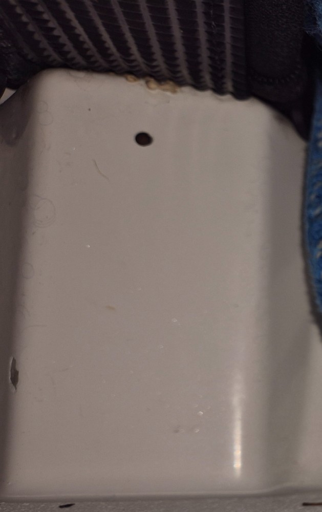

I've attached a picture of where the breather hole is, right up under the toe strap at bow end of cockpit. If there were no breather hole, you'd be at risk of popping your seams on a hot day in the sunshine, and sucking water into the hull every time you launched into colder water.

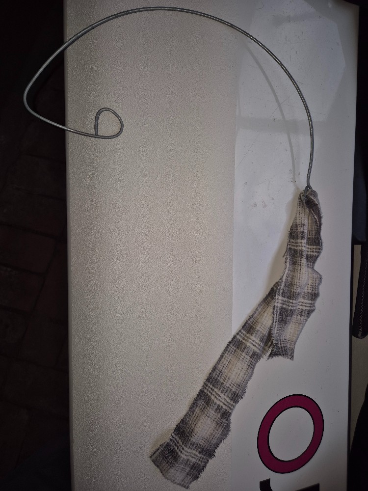

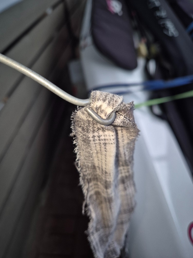

Even then, you won't get the last bit of water out, for that I have a curved wire loop to push a strip of cloth into the lowest part of hull (picture attached).
