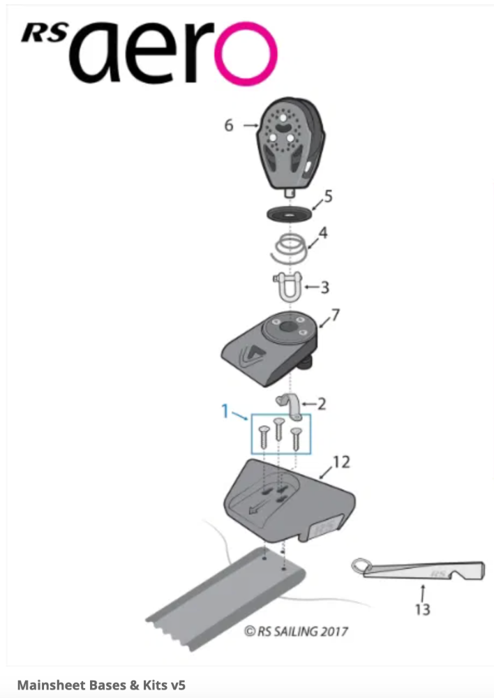

Since about sail number #2100 RS Aeros were supplied with an easily detachable mainsheet block base with a quick release catch. This assists the speedy stacking of RS Aeros when necessary for transport. The new base is attached to the hull with 3 screws, rather than 2, for added security and to take the loads of the optional swivel cleat accessory, for those who wanted that option.

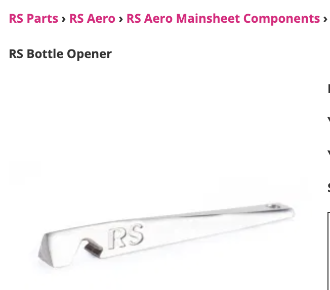

The RS Aero Triangular Key (also known on the RS Sailing Store website as the 'RS Bottle Opener') is supplied with all new RS Aeros and fits into the triangular hole at the back of the fitting to release the catch and allow the mainsheet set up to slide off backwards. You do not specifically need to use that bespoke RS key as a screw driver or your house keys can just as easily be inserted to release the catch. The RS Aero Triangular key is however also handy as a bottle opener at its the other end, to celebrate your new toe strap!

First of all I used the triangular tool to push in the catch next to the mainsheet block. Then placed the block of wood against the mainsheet block support and tapped it out (gently!).
I undid the three screws found underneath, lift off the plastic mount and you'll find the toestrap will release. Then I unscrewed the two screws in the middle of the toe strap and the two towards the bottle holder near the rudder mount. Dont forget to undo the elastic at the back that holds your drink bottle down if you havent already done so.
I then applied a small blob of sealant over the 7 screw holes before screwing in all the screws and put the new toe strap on. You might find it easier to loosen all the straps before fitting it so you have some wriggle room with placing the toe strap. At the mainsheet end I found it easier to put the screws through the black plastic and the three toestrap holes before placing over the holes to screw in.
Grab the mainsheet block and support and push it back into position. You might need the hammer and block of wood to gently persuade it back in until its flush. Reattach the bottle elastic and adjust the straps to your preferences and you should be fine.
