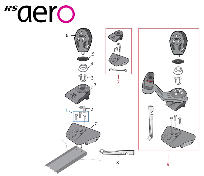

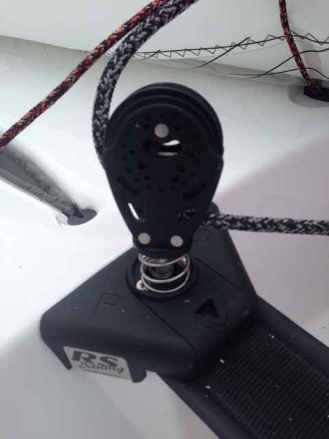

RS Aero Mainsheet Base Upgrade and  Centre Jammer Swivel - LINK HERE
This mainsheet base upgrade is available to incorporate a centre jammer swivel, an option for those who want it.
The new mainsheet base is fitted to all new RS Aeros now (since about no. '2150') and for anyone who wants one it is able to be easily fitted. It serves three purposes;
- allows the fitting of the mainsheet centre jammer swivel for those who want that.
- if ever you want to stack RS Aeros for transport it allows quick and simple removal of the mainsheet ratchet (similar to the kicker base removal).
- this 'upgrade' provides RS Aero sailors with a good excuse to buy a dual purpose RS Bottle Opener, used to remove the base for stacking Aeros and to open a beer once pack up is complete!
Most Sailors will not want a centre jammer but there have been quite a few enquiries since the launch of the RS Aero from people who want the option for various reasons. Whilst the demand is a very small proportion RS have responded to provide the option. Some people are used to centre jammers from previous classes they have sailed and others may not have arm strength due to age or size. In some cases people have a long term injury and want the cleat to take the load. Non racing sailors who want to cruise with less effort and have a hand free could be interested too.
The side cleats work well upwind, which is the main time you might need them, this is an alternative that can be used from more angles.
It is an option for those who want or need it.
The photo shows the new base with a normal ratchet. The Harken swivel cleat can be added.
