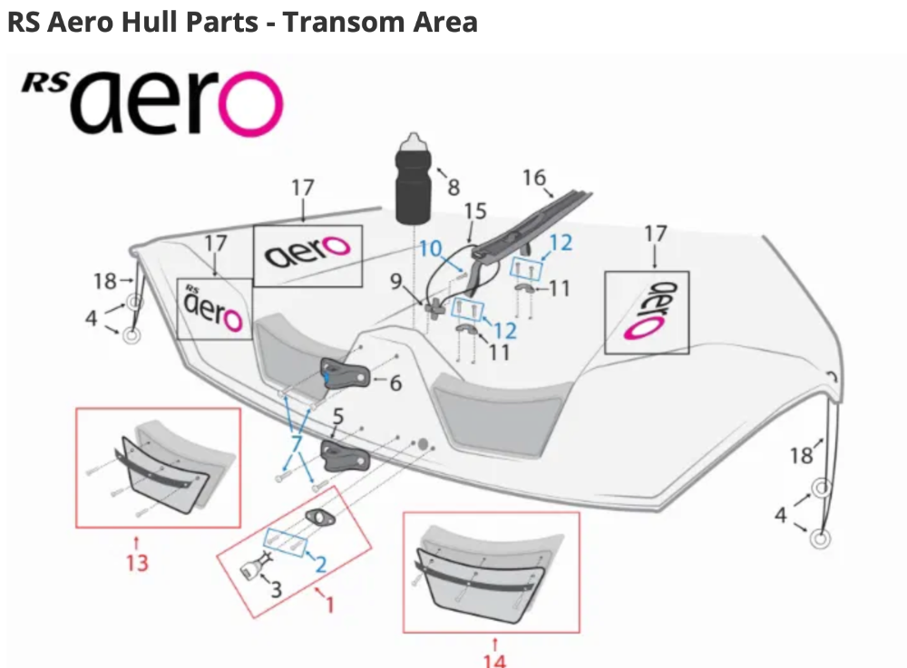

The two holes at the rear of each gunwale were to attach the bungee take ups to the control line tales, when RS Aeros oringinally had the control line tails led under the gunwales. The preference evolved for sailors to lead those tails over-deck, as permitted in the Class Rules, and in 2019 RS Sailing started supplying new RS Aeros that way and no longer added the holes to the rear of the gunwales. The through gunwale fittings and the under gunwale barrell leads were also removed from the spec at that time.

In the past they were used for the underdeck control lines (outhaul and downhaul), as far as I know. Due to the fact, that actually the control lines are overdeck these things are not anymore required.

What are the loops on the transom corners for?
Looking at the parts page there are items 4 and 18.  My Aero doesn't have these or the holes in my hull for them. What are they for?
