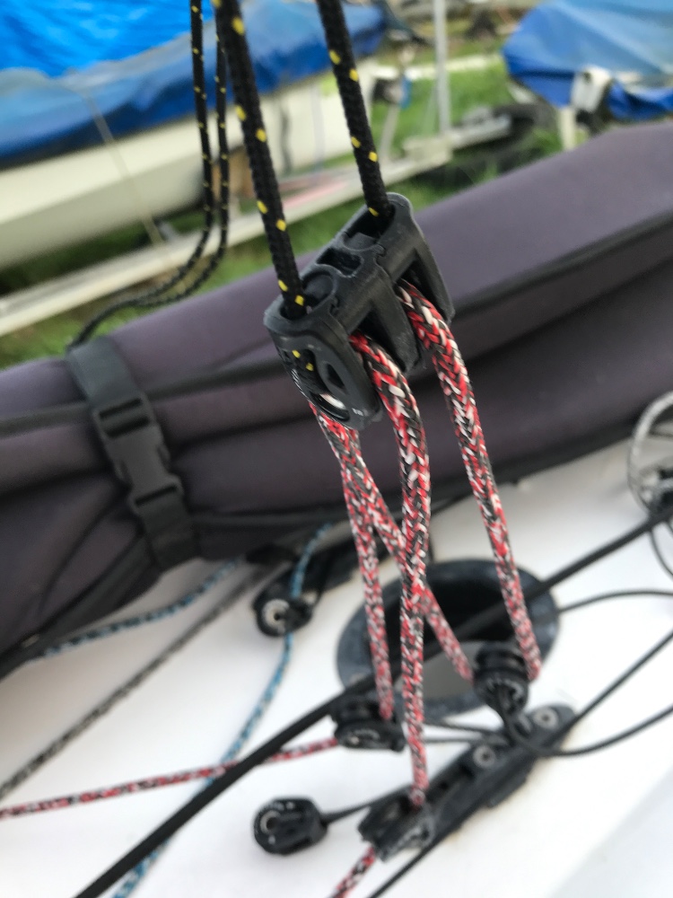

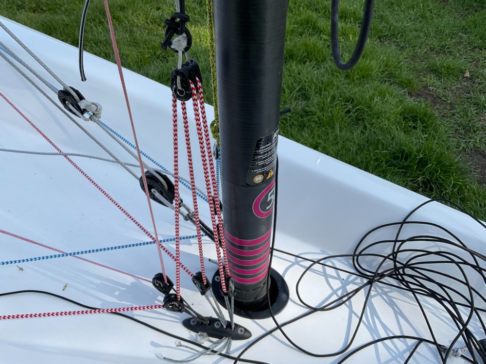

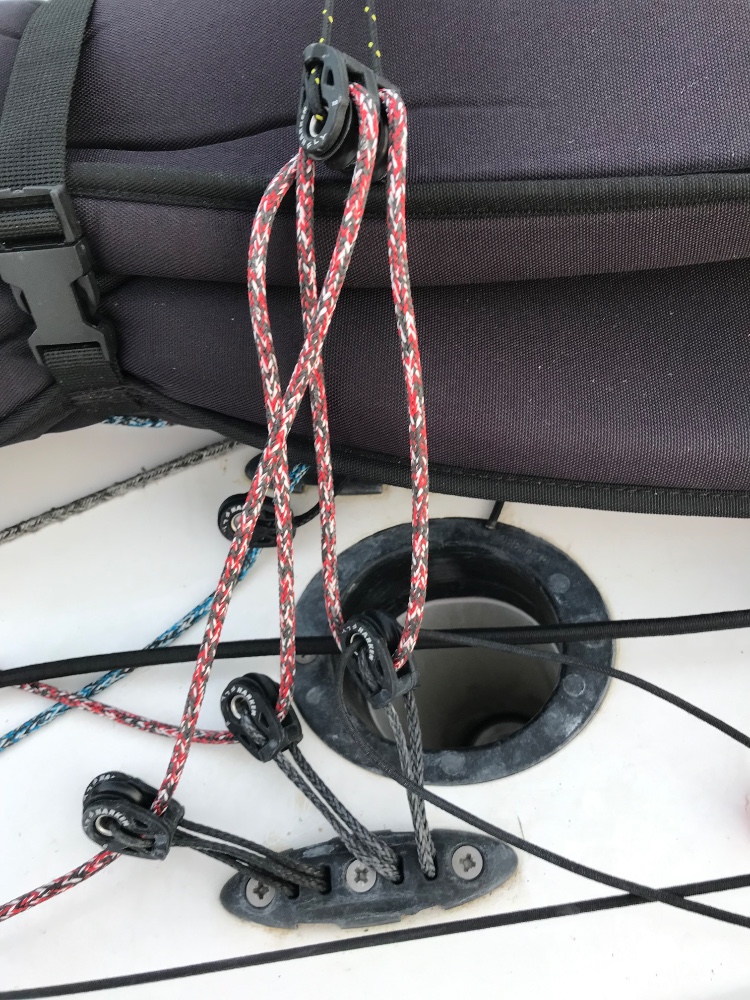

Hi Oscar,  I havre sailed Aeros since 2014, having had two boats.  I converted my 1st to 3 single blocks, and then did the same with my 2nd 2022 boat; which must have been one of the last delivered with a double block on the Stbd' organiser.
The rope arrangement I arrived at after much experimentation is shown in the attched photographs, and is not the immediately obvious way to thread the blocks.  The main characteristic is to thread the 3rd block off opposite sides of the upper double block so that under tension it tends to align with the upper block.  Whereas if it is threaded off the same side it tends to align at 90 degrees, ie across the two sheaves, to the upper block.  I have all rigs and do sail 5 and 9 occasionally.  The range of downhaul, and hence upper block movement, is greatest on the 9 rig.  So really cranking on downhaul with the 9 rig can lower the height of the upper block above the deck and the lower blocks significantly.  Hence i found it better to rig this way.
Also when sailing downwind in light airs the boom will be out beyind 90 degrees on either side, port or starboard.  That twists this whole set-up, particularly when out to port.  And was a reason for moving to 3 single lower blocks.  Twisting either way in this set-up means all 3 lower blocks find their own alignment without binding; either on each other or the mast.  Swinging boom out to starboard and the Vang Kicker presses on the downhaul as the boom nears 90 degrees.
My downhaul line is as supplied by RS, and still has the end loops tied togerther.  I have thought about replacing and splicing continuous line.  But find the tied loops never get beyond the slack part of the line, and are easy to re-centre between races.  Whereas I doubt I could splice line end to end without creating a section larger than the origiinal. Which I doubt will settle in the clam cleats as well, and it will certainly not pass through the blocks as easily.  The standard 4 mm line is close to the blocks'  5 mm maximum.  It would also be harder to replace.  So so far I've stuck with the as supplied.
This is a rig-up I have arrived at, and used for many years.  There my be others.

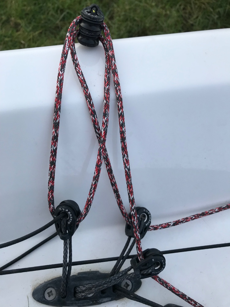

Hi Oscar,
Deck Organiser Blocks
The Class Rules permit changing the downhaul base deck organsiser double block to two single blocks (C.6.1.3.v) and in 2022 RS Sailing started supplying new RS Aeros like that as standard. Therefore there are now 4 single blocks on the starboard organiser at the mast step, rather than 1 double and 2 singles. The Rigging Manual will likely be updated in due course, although it is not necessary as the Class Rule permission already covers it. Whilst not a necessity this is a nicety, so a nice upgrade going forwards.
See the attached photo as an example on how you might rig the line (*Thanks to Isabelle from Dalgety Bay!). I suggest you rig it up, try to ensure there are no twists in the line, and put it under tension to see which way works best without it twisting as you add and release the tension. Maybe sail with it for a couple of times before splicing it, if you are unsure.
