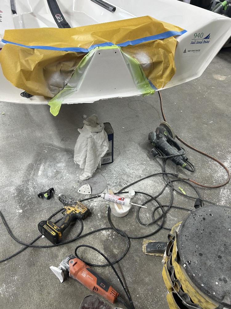

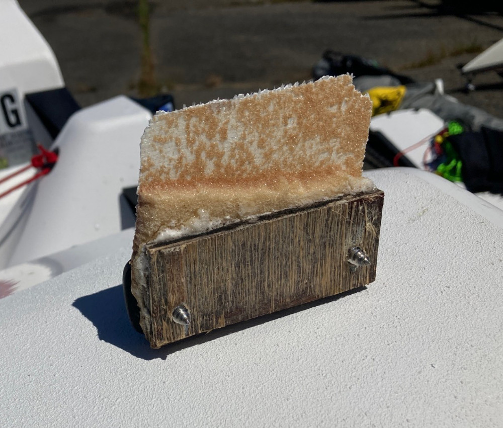

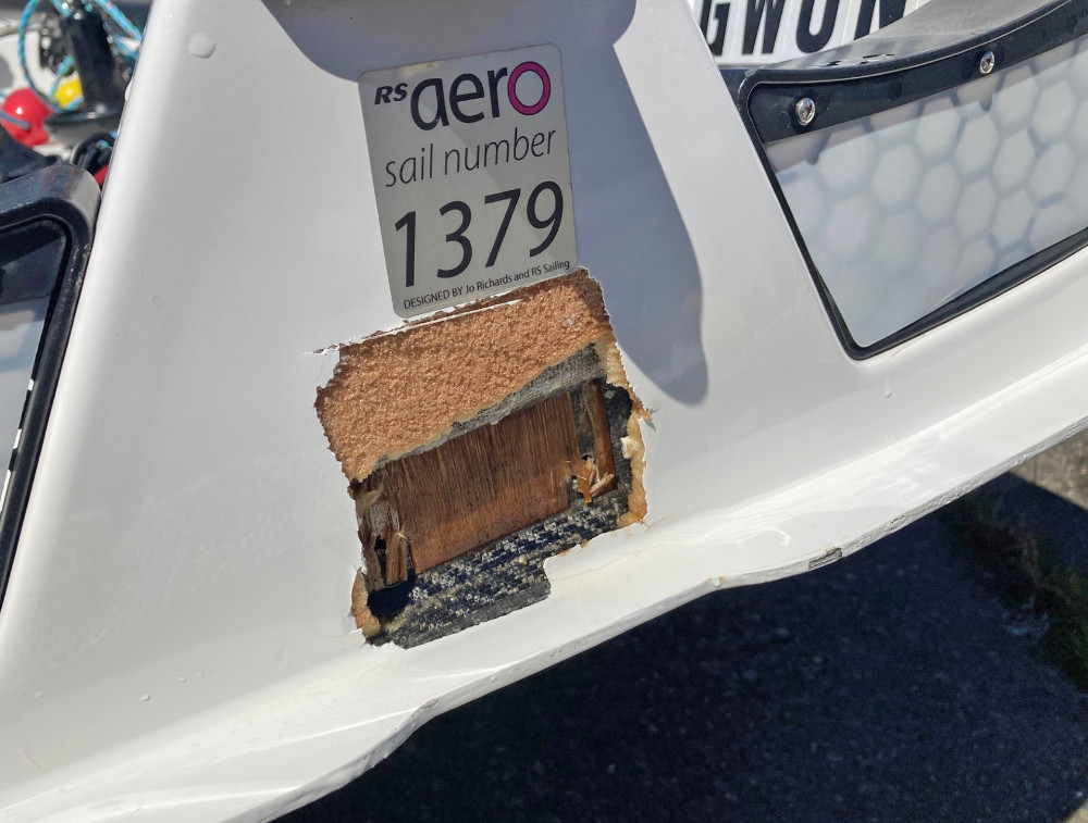

Ok, here is an interesting one for everyone out there. I was sailing along on a nice day when I started hearing an unusual grinding noise from the back of the boat. When I stopped to take a look, I discovered that the lower gudgeon had broken off from the transom! Like, “This isn’t good.” The rudder was still attached with the upper gudgeon so I immediately headed back to the dock (from the opposite side of the lake of course) trying to be very gentle in my steering. When I took the rudder off, the lower gudgeon and transom piece fell right off.
If you look closely at the pictures, the rectangular piece of plywood delaminated from the transom carbon backing and the gudgeon screws pulled right out (along with the outer gelcoat). The upper gudgeon was not affected nor were the rudder pintles.
I was lucky enough to find a local Seattle repair outfit that had worked on other Aero repairs who could do the work right away and at a reasonable price. The repair involved adding a carbon layer to the inside of the hole, gluing the plywood section that had popped out back in, adding another layer of carbon to the outside, and using longer screws. I got to pay for this myself as RS Sailing decided this was not a warranty issue as the boat was too old (2015).
