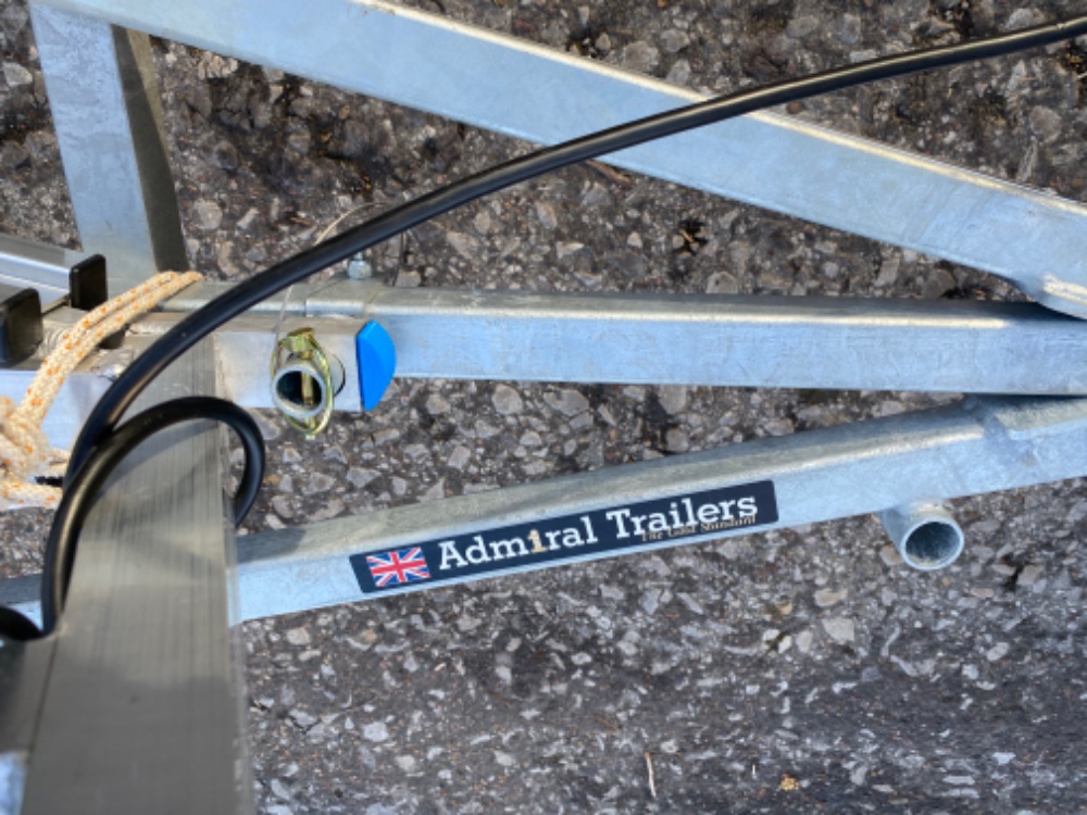

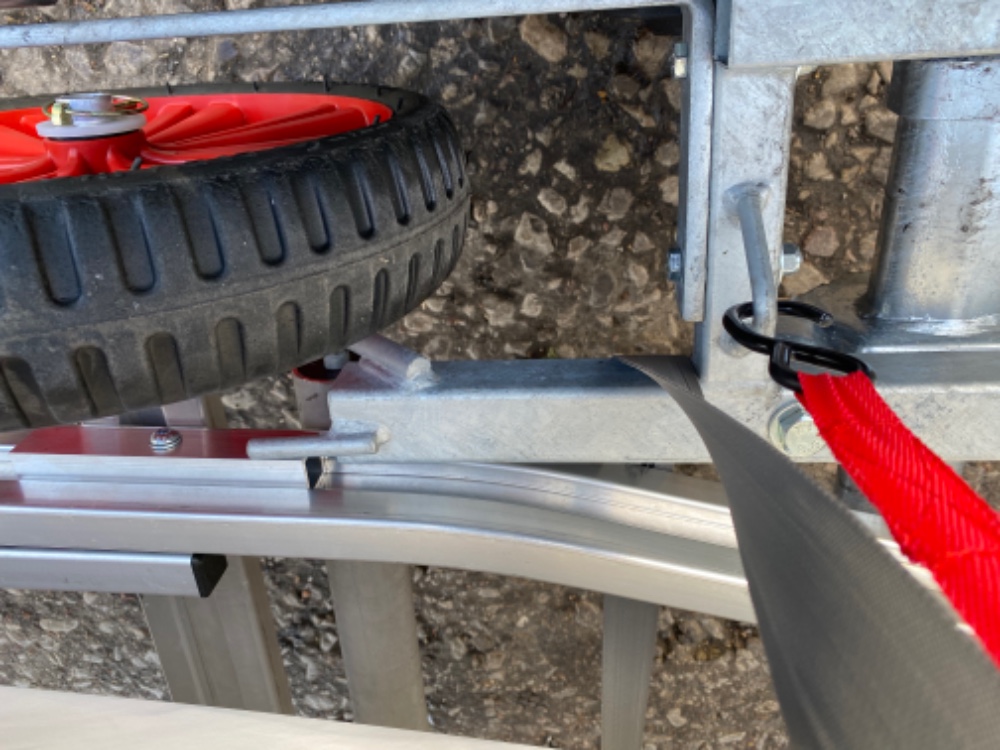

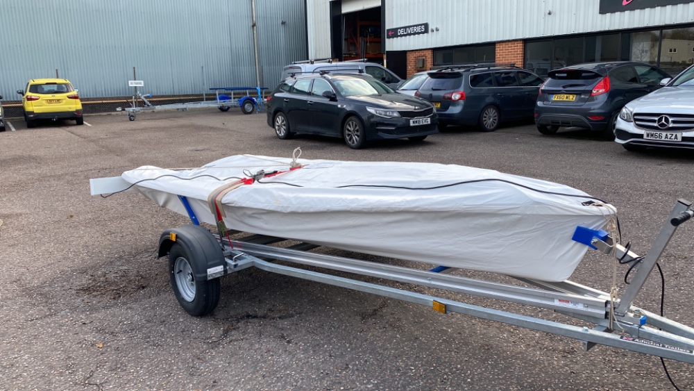

I bought an Aero trailer from Tony Blackmore at Admiral Trailers as based in Devon near me & recommend it. Went for 10 inch wheels and extended lighting board arms. Trails nicely behind the car & reassuring to see the reflector on mudguards. Comes with legal full width lighting board and cable ready to hook up. Suggest:Remove lighting board arms when Aero off trailer to prevent trips & falls! They're a hazard. Spigots that lead Aero trolley into trailer not a great fit so you can either adjust or widen them using metal tube/ hammer  or purchase slightly larger box sections & replace those. I've also added a large plastic washer to cut down rattle on the road base/ trolley clip. Finally, useful that the road base clip is fully adjustable so that trolley is a good fit. It's a well made trailer.
