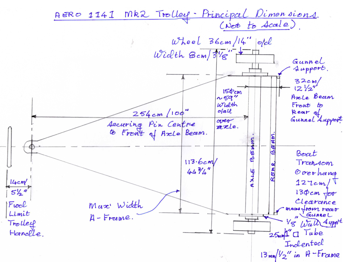

Hi Tim,
Yes, narrow roof bars are a common occurrence especially on smaller cars. When RS used/lent sponsored Volvos they had to use the standard Volvo roof racks and were limited to narrow ones.
Place one of the two rear RS Aero trolley (standard UK supplied) cross beams directly on top of the rear roof bar and lash both ends tightly with two separate ropes. It is critical that it does not move at all, otherwise it will no longer be suppported, so;
- Lashing around at least 4 times will ensure it can still be tight after tying the knot.
- To avoid risk of chafe watch out for any sharp points (there should not be) use a thick string (5-8mm) and a non chafe string (ideally dyneema core)
- Use two ropes, one each side, in case one fails.
Note - The standard UK supplied trolley changed a little to a Mk3 since that early diagram, so check detail
Also, see another relevant post here too;
https://www.rsaerosailing.org/index.asp?p=forum&fid=14&tid=8045
' Roof Bars
- The UK supplied trolley's fore/aft longitudinals are 114cm wide (check your own, just in case of version change). So you need your roof bars a few cm wider than that. My roof bars are 120cm wide not including end caps which I think is good as a minimum.
- The width inside the trolley wheels is 128cm, so I can leave my wheels on and they sit neatly outside the rear roof rack bar.
- Some cars are limited to narrower roof bars. Then you need to lash the trolley cross beam/axle very tightly directly on top of the rear roof bar. The trolley narrows going forward to engage the front roof bar.
- For upside down, check deck high point width. '

Question regarding shorter bars. The bars I have currently are a yakima flush bar where the end of the bars are truncated (https://www.yakima.eu/yakima-flushbar). This means I have a bar which is essentially 1 m wide.
Looking at Peter's diagram, the max width of the A frame is 1.13m, so I won't be able to sit the A frame on the rear bar with the axle beam behind the bar as I think would be the most desired position. Therefore, my question is...
Can I safely secure the axle beam or rear beam directly on top of the bar, and has anyone previously done this and be willing to share what steps they take to secure to boat.
Thanks, Tim.

Whilst on the subject of trolleys, here is a measurement diagram for the Mk2 RS supplied trolley that Jonathan Rickels produced when he was arranging a trailer base.
Thanks Jonathan!
It might prove useful to some RS Aero owners at some stage as a guide.  It is still always worth checking your own though, as there may be small variations whist specs were finalised or improved on.
