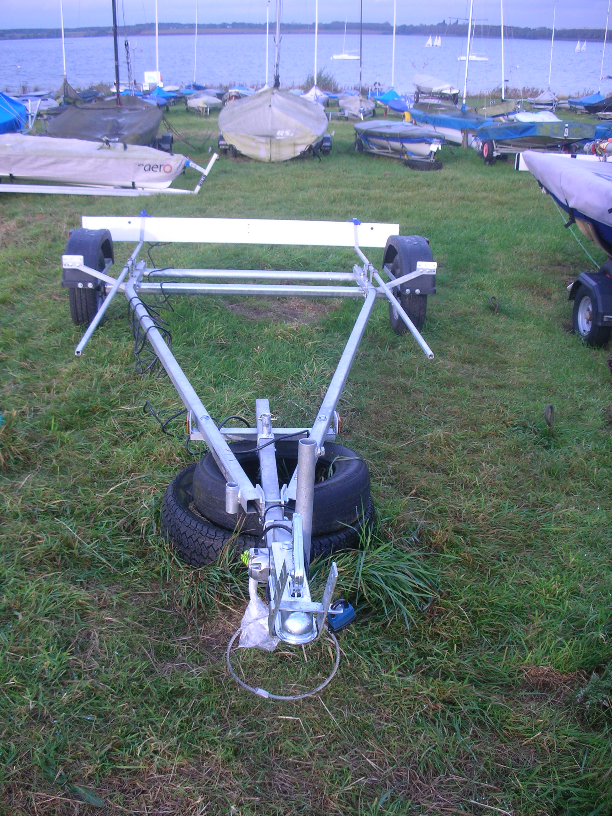

Follows is a picture of my Admiral trailer with boat on trolley behind.

hi, I recently put down a deposit for an Aero, so hopefully be joining you on the water soon.
Previously I've just done club racing, so have no experience with road bases etc.
I am planning to buy an RS 250-275 road base at the same time. There's no picture of the roadbase on the RS website, so I'm hoping someone can share some basic tips. For lighting board, will a 4'6" board (with fog light) be the right size? Also, is a 6m electrical cable long enough? Am I better off making a transom mount, as I've seen in a few posts on this forum, or does this roadbase have another option?
Thanks in advance!
