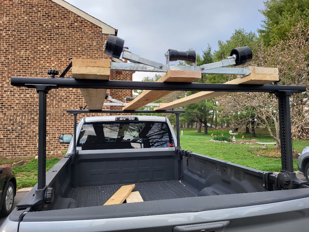

I will be removing the center board because it is not needed when I take the set up down to stain it black to match the rest of the rack.

It would be better if the center roller on the back was longer. Pushing the boat up is no problem because I can see where the hull is on the roller but taking it down I lose sight if where it is on the roller.

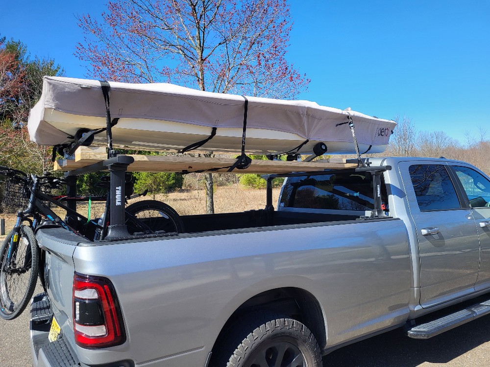

  1. This is how I figured out how to transport my Aero. Thule adjustable racks and 2×8 ×8 Lumber and 2 trailer cradles. My original plan was to put the boat on top with the dolly but the dynamic dolly we use in the US is not meant for this because I tried. So I opted just to put the boat up top and it has worked out beautifully. I needed to do it this way because I plan on bringing this boat with me when I travel across the US pulling a 27 foot travel trailer or what you would call a caravan in Britain.
