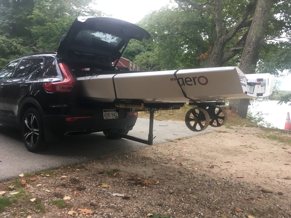

Here is the use of the truck extender which allow me to lift only half the Aero weight.  The Aero is supported 4 places on the rack and a round swimming foam noodle in the car is used as a roller for protection and loading.  Eight feet is supported and 5 feet hangs over the extender with the Aero strapped in 2 places.  The kayak dolly stays attached when transporting.  This works great for my 1.5 mile back road drive to a launch site on the local lake.

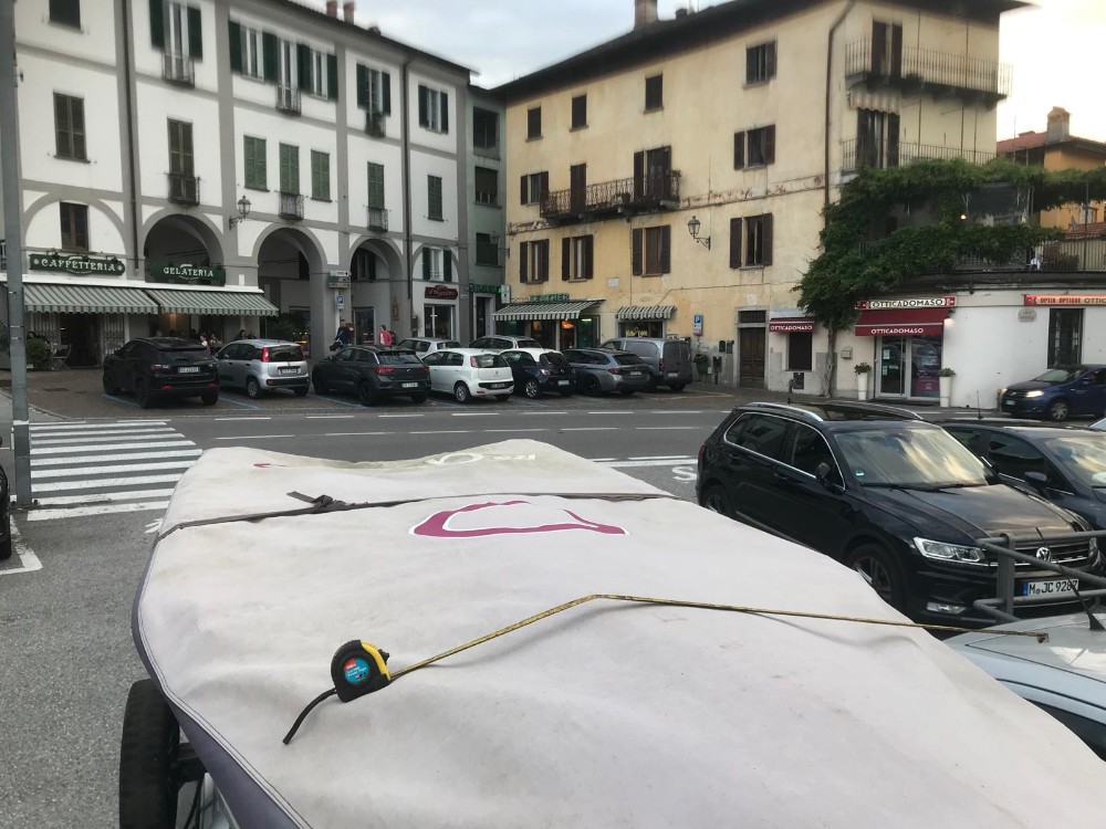

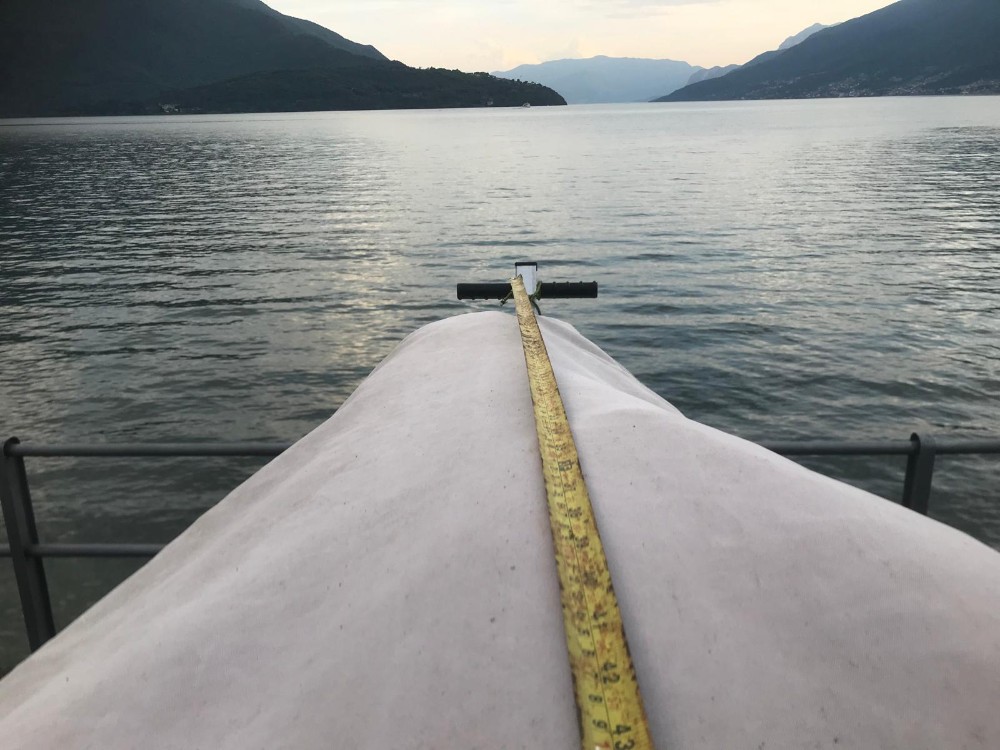

I managed to measue this for you last night. It was a little awkward as I had my RS Aero on the car roof!
The RS Aero beam is 1.02 meters (40 inches) at a distance 1.50 metres (59 inches) back from the bow.
I hope this helps and you are able to make it work for you,
