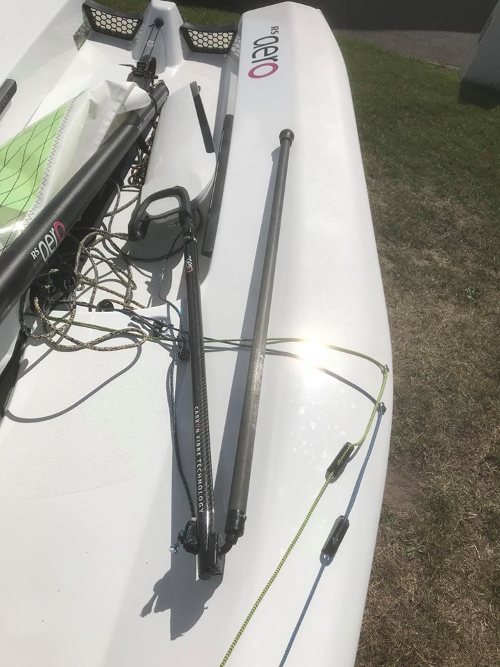

 When tiller extensions are brand new the plastic UJ is still ridged and untrained. The tiller extension will naturally stand bolt upright. Pictured here on 'Dasha III' (Photo1)

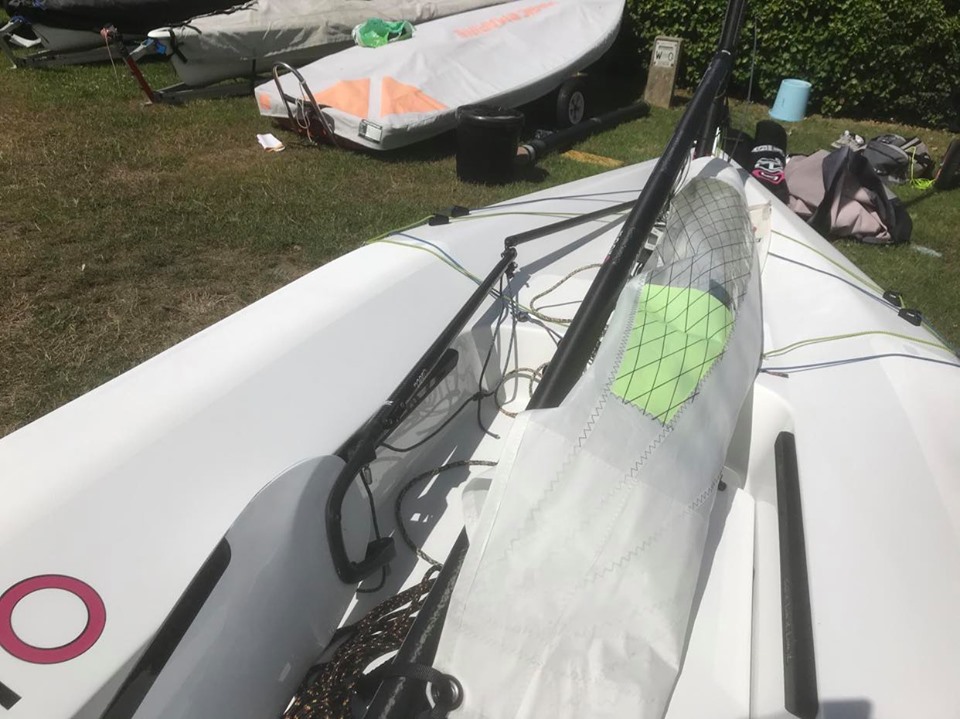

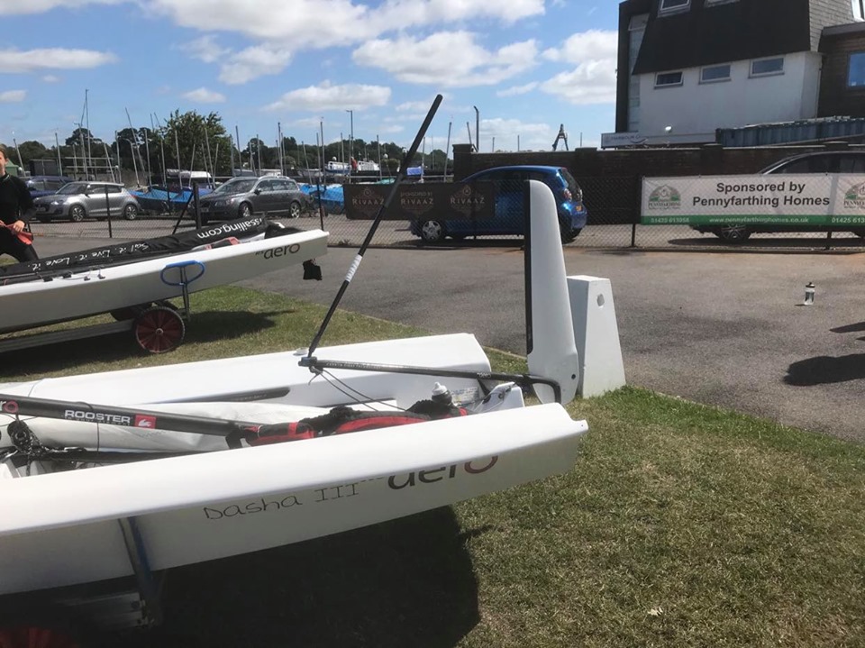

 If you leave the tiller extension pointing backwards alongside the tiller (Photo 2) whilst at rest then it will spring away from you backwards (Photo 3) if you drop it, to be out of reach and hard to retrieve easily. That's bad! 💦

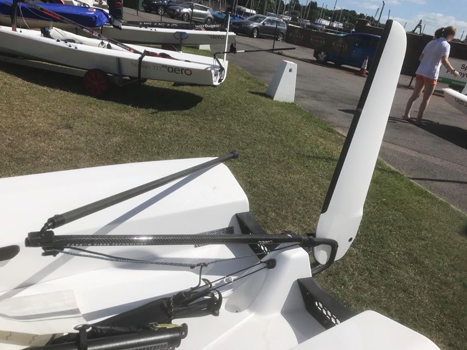

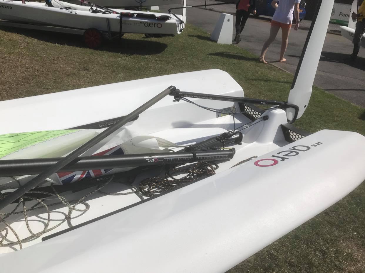

If you leave the tiller extension extended forwards down the boat whilst at rest (Photo 4) then if you drop it during a tack it will stay forwards and bounce in front of you (Photo 5). This makes a quick re-catch possible, especially if you already have your boat well balanced (heel vs trim) and the rudder is neutral so it auto steers straight for a moment. Pictured here on 'Dennis the Menace'.
