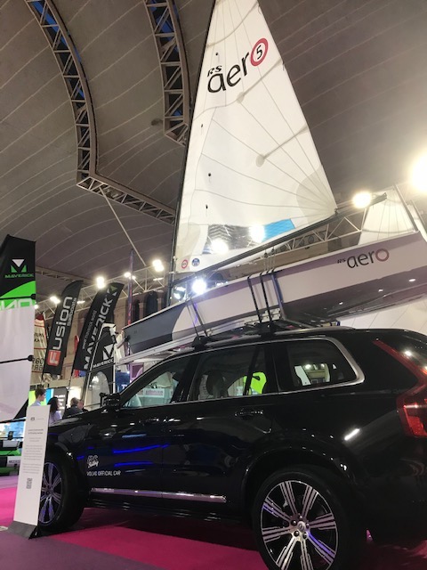

Which Way Up?
- The UK supplied standard 'A' frame gunwale hung RS Aero 'trolley' is ideal for loading the right way up together like this, as they cradle and protect the RS Aero. With the raised side decks all the kit (rigs, foils & sails) can stay neatly on the boat under the covers.
- If you are using the more lightly built USA 'dolly' that dismantles then you likely need top car top the RS Aero upside down. In this case be sure to have sufficient fat padding on the bars to protect the top of the deck and don't be temped to ratchet it down overly hard. '
Roof Bars
- The UK supplied trolley's longitudinals are 114cm wide (check your own, just in case of version change). So you need a few cm wider than that. My roof rack is 120cm wide not including end caps which I think is good as a minimum.
- The width inside the trolley wheels is 128cm, so I can leave my wheels on and they sit neatly outside the rear roof rack bar.
- Some cars are limited to narrower roof bars. Then you need to lash the trolley cross beam/axle very tightly directly on top of the rear roof bar. The trolley narrows going forward to engage the front roof bar.
- For upside down, check deck high point width  '
