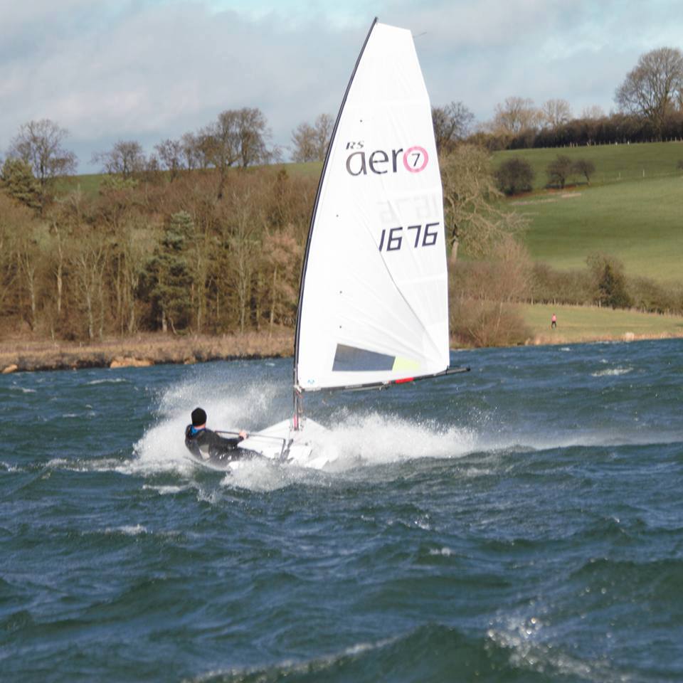

23.9kn - Northampton, UK, Feb2016
Here is the video!
Be sure you are stable on your chair and MAX the volume!
The second (port) reach was the big one with max speed peaks of both 23.9kn (27.5mph) and 23.1kn (26.6mph) recorded, visible at 0:28-0:39 seconds on the vid.
Notice how flat the RS Aero is during that period. Otherwise it would be slower and uncontrollable at that speed.

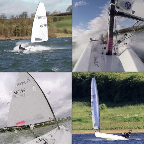

Anthony York, AKA 'Chunky', of Northampton SC is our Class webmaster and our heavy air stuntman too! In Feb 2016 he launched at Northampton into a winter gale as 40+kn gusts were recorded at the clubhouse. He latched onto the front of one of those gusts as it smashed down onto the lake and sent his RS Aero bouncing over the wave crests at 23.9kn, a GPS speed yet to be beaten and the rest is history! He has learnt a few lessons sailing his RS Aero in extreme weather and shares them here to save us all having to learn them the hard way too!

Handling:  As the wind gets to the point where you’ve run out of travel on all you’re control lines, that’s when it’s time to just concentrate on staying upright and keeping out of trouble.
Don’t try to fight the boat, try and release it, it will shoot from underneath you if you do. Make sure you’re ready for the acceleration though!
The boat is very light and the rudder works very well, so try not to use it as a brake as everything on the boat will then become very heavy. Bear off, keep your kicker on at least half for control and enjoy the ride (on my record run in 40+knots I had the controls set the same as upwind (everything was on full!).
Flat is fast! Hike hard to pin the RS Aero bolt upright on a planing reach to benefit from the planing hull form.
