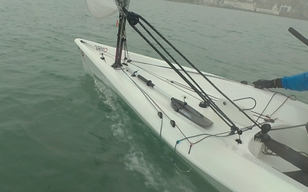

This setup seems to work well for attaching a paddle to the deck. It's held with two elastic shock cord lengths with suckers, one near the top, the other across the blade.
These are the suckers used, https://www.amazon.co.uk/IKAAR-Suction-Sunshade-Plastic-Sucker/dp/B08HMJZHLJ/
I also take other bits of string or cord to centre the tiller if I needed to paddle back.

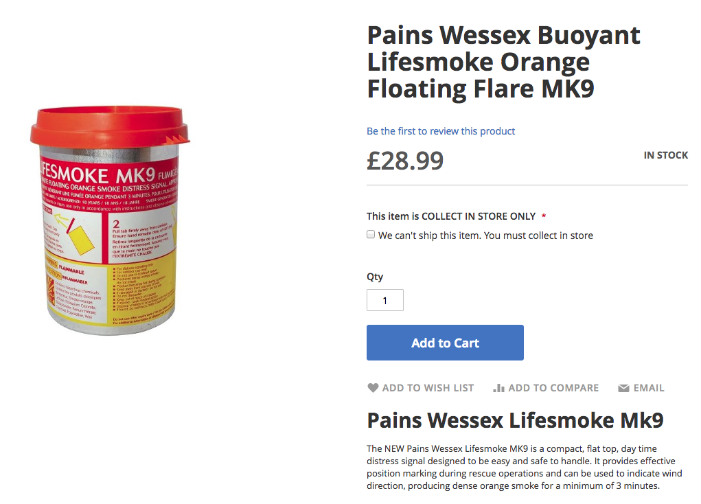

  • Consider the need for a smoke flare or EPIRB [I used to carry one on my Moth when sailing alone in the winter].

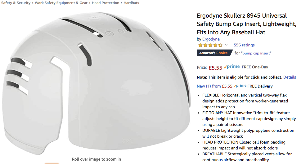

  • Rigid Cap Insert: If you don't want a full helmet there is a reduced option popular with our North American RS Aero sailors which is a rigid cap insert that can fit discretely inside a cap, sun hat or fleece/woolly hat. They can be bought cheaply on Amazon and I have one on order. Link below.

Marc Jacobi, double RS Aero 9 World Champion says;
"I wear a rigid ball cap insert, purchased on Amazon. It came in handy at the Gorge last year when another boat's boom whacked me on the head between races, but I barely felt it! I like the insert because it doesn't appreciably raise the height of one's head, unlike a full-on helmet. Additional benefit: it fits inside my sun hat, so sun protection isn't compromised. Impact protection isn't as good obviously, but I'm OK with what is provided."
Gregory Popp often sails alone on the east coast of Florida, USA, and is a keen advocator of wearing head protection having witnessed some injuries;
"I wear a ball cap light helmet insert in light to moderate winds and a full helmet in strong winds. I got tagged pretty good last Sunday but wasn't hurt as my insert protected me. It is the same as baseball players use, is totally discrete, very inexpensive, and I don't even know it's there. I am a big proponent of head protection as the one injury that can take a lasting toll is a brain injury."
to fit discretely inside a cap, sun hat or fleece/wooly hat.
Compact, easy to use and affordable

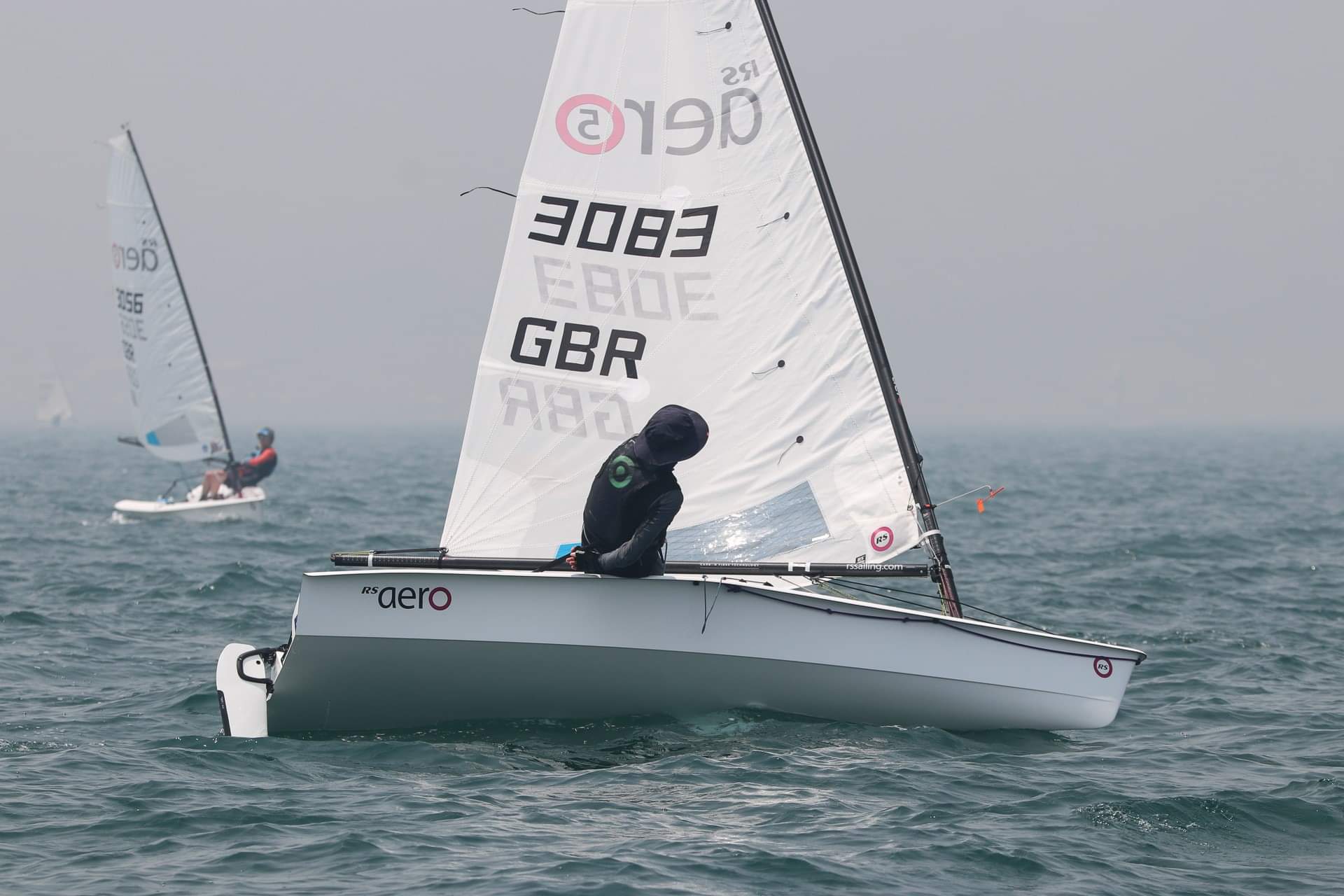

Helmets
on a breezy day at the recent RS Aero Worlds in Australia, Jan 2020

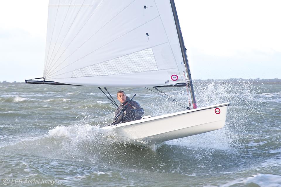

Big Thursday - Lymington, UK, Dec 2014

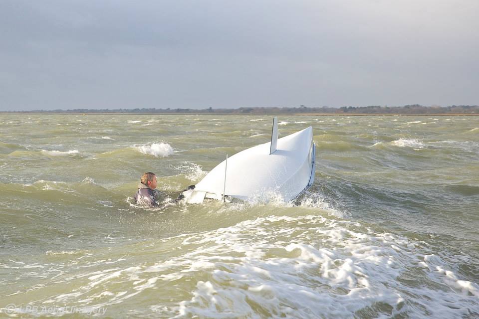

Good news!
If the RS Aero's carbon mast grounds when turtled in shallow water it is strong enough to support the weight of the lightweight hull in the waves.
I tested it so that you don't have too!
