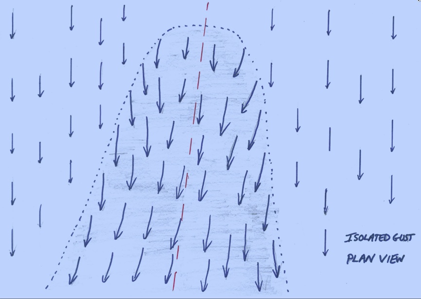

So back to the more friendly convective gusts. As per my drawn example, the theory is that in the northern hemisphere, due to the Coriolis Effect, a gust will veer at the surface relative to the mean wind direction (see axis in red). In addition to this, due to the Bernoulli Effect, there will be a bend in the wind at the edges of the gust. This is where the fast moving air at low pressure intersects with the slow moving air at (relatively) higher pressure. Hold that thought for a minute.

Here's a third way in which gusts can give you gains:- So have a good look at the sketch plan again. If you spot a well-defined gem of a gust surrounded by relative calm, there is a good chance that you can make some huge gains upwind by tacking across into the side of it. Most gusts hit the water and fan out down the lake taking a conical shape in the plan view. It is generally thought that entering a gust on a starboard tack will get the best result, taking advantage of the veering. From about half way and upwards in this example you can get Bernoulli lifts at the periphery of the gust on both sides of the cone. If you are really lucky and get in the groove of an entire gust, you can climb up the cone of the gust gaining lifts on both sides and on both tacks - that's the beauty of their shape. If you've ever thought 'how the hell did that person go up that beat so fast', it's probably one of those rare occasions that somebody got the gust cone exactly right, winning on every tack. Rare, but my point is, get yourself in the pressure – you have to be ‘In it to win it’. One last warning: - when you do first hit the gust, whilst your boat is travelling slowly, there is an immediate change in apparent wind (aft) which will compound the Bernoulli lift at the edge of the gust. So be prepared to put the helm down rather quickly and follow your tell-tales. There is usually a subsequent bearing away as the apparent wind moves forward and the edge effects lessen. Not paying attention at this point can result in a scary panic with much spilling of precious power or a knock down to those that don't point up and don’t ease the sheet(s) as the pressure comes more on the beam.

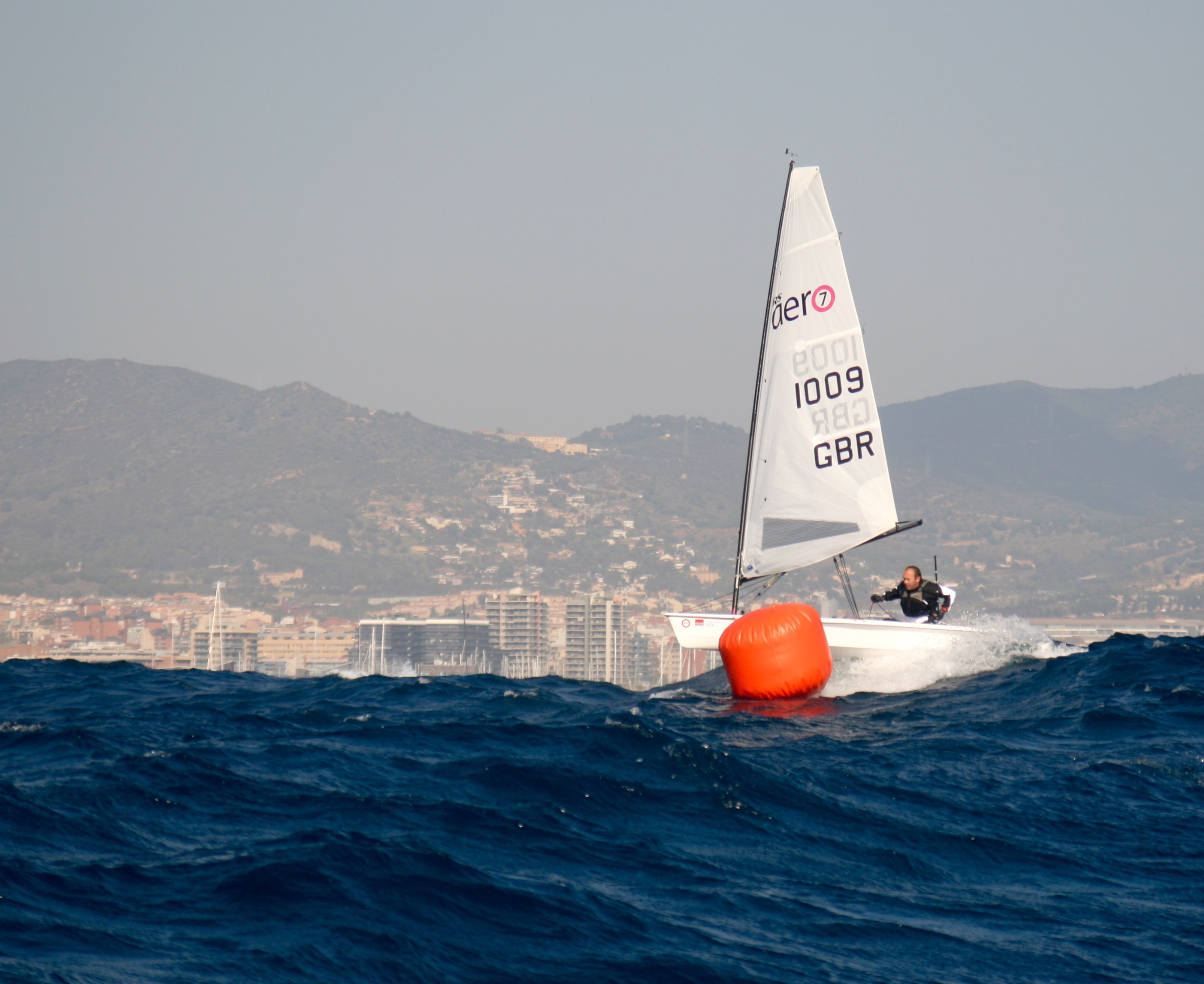

Top Photo; RS Aerocup: Barcelona, Spain, Oct 2015. When racing was cancelled on Big Sunday the RS Aero 9 sailors rigged up their RS Aero 7s!
