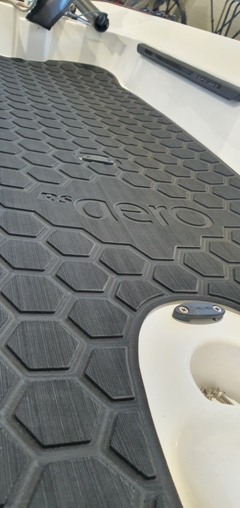

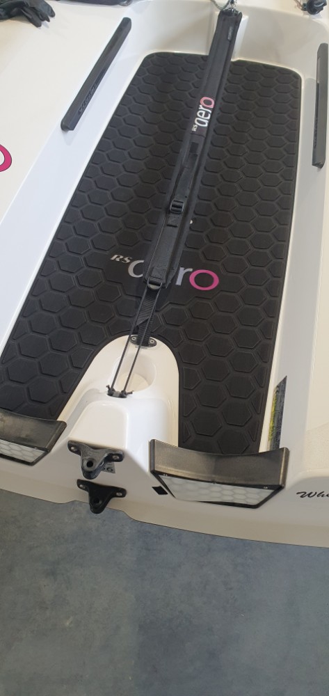

yes it is 3mm and well i sand it because adhesion of glue. i thing it will be working also without but this like this the adhesion is better. the sand deck is not complety glossy only make it softer.
10/10/2023 06:47:00
SamuelM4
Posts: 3
 Looks great, but I would be weary of the class rules and sanding the deck underneath if you ever take it off (as I'm sure you have read).
It's less than 3mm thick right?
10/10/2023 06:25:00
cerealk777
Posts: 24

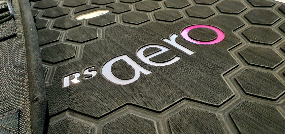

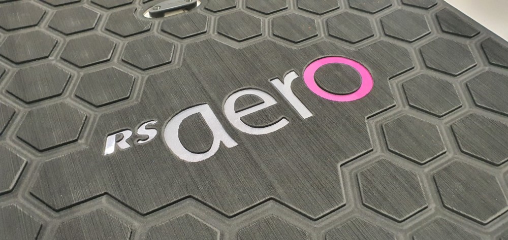

I made this from high density foam UV stability on mill machine and logo is made from anodised aluminuim plate cuting by fiber laser. deck is selfsticker on boat, but it nessesery to bit of sand the surface for better adhesion.

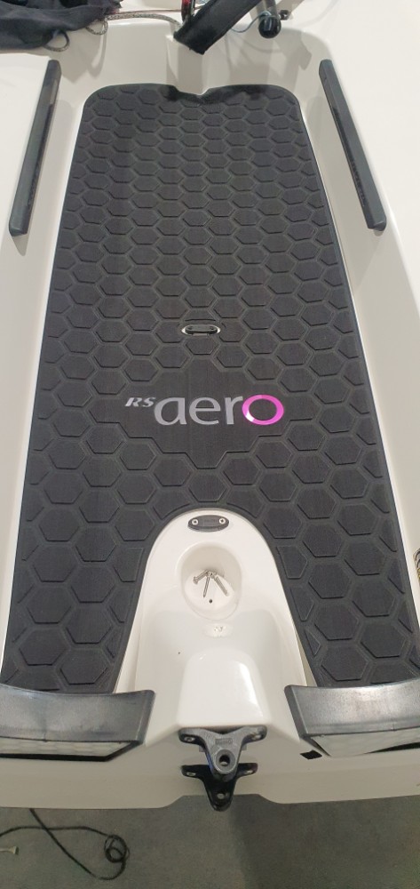

Overall, it is pretty easy. Easier than installing sail numbers because the nonskid serves as an alignment guide.  The section of decking for the area around the dagger board is small enough that it is easy to handle the material and move into place. I had to use some shockcord to tie back some of the control lines.
The big section for the cockpit floor is a little more challenging. I had to disconnect the hiking strap from the two aft anchor points which is simple enough. I installed the aft 1/3 of the section first to work around the hiking strap anchor point in the cockpit. I think this is the key first step for the cockpit - get the aligment around the anchor point right and then radiate out from there. I then removed the backing for the forward 2/3 and worked it from stern to bow. I would repeat that same process if I had to do it again.
If the class modiifed the rule to allow the cockpit to be done in two sections - port and starboard halves, installation will be even easier. I am going to add some sealant underneath the hiking strap anchor point as there is potential for a small amount of water to pool there with the decking installed. I also suggested the class modify the rule to allow a small drainage channel from the anchor point aft.
One note if anyone orders from Raptor. The class rules do not allow any logos or text to be embossed into the decking except the RS logo which is optional. In my opinion, the RS logo does not translate well as an embossed graphic in the decking. I recommnend ordering without the logo.

I installed Raptor Deck on my Aero this week. I think it looks great in black and haven't seen any photos yet in that color option. I will post one here for reference for the communtiy. We have eight boats at my local club. After seeing my boat, I know at least three other owners are planning to install the decking as a winter project. It is a big improvement. I am surprised more owners haven't done it.
