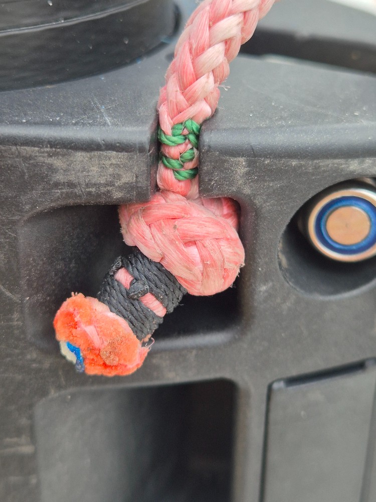

I would encourage the stitched method.
1) it doesn't wear out like tape, nor bungee;
2) it doesn't add the further step of remembering to rig through the bungee loop;
3) it is 100% secure, CAN'T be pulled out by force, unless you first push the stitched portion back down to release;
4) I did previously try the bungee loop method, to try to stop a knot repeatedly popping out (my tail was on the thick side, and the knot too bulky to sit fully snug), but the tail was still popping out at the worst time, when I was applying max downhaul - so I went to a thinner tail, and added thickness above the knot with stitching - problem solved.

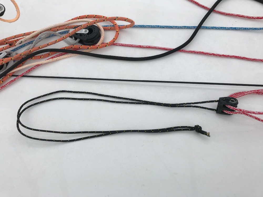

Hi Marc,
There is an alternative:-
The downhaul orimary supplied in the rope kit is 4mm tapered to enable threading through the upper two sheave block.
The minimum recommended in the Class Rules is 3 mm.  I have for many years used 3mm doubled.  Vectran on my boat, but Dyneema or Spectra should be just as good.  It's just as easy to thread through the two sheave block.  Turns slightly easier through the sail cringle.  And the two lines tie a neat double figure of eight knot and slip easily into the Gooseneck slot.  In 10+ years sailing Aeros, all rigs, in some strong winds though some may have sailed in stronger winds & waves, it has NEVER come out of the slot.
On rigging before launching I always test the hold of the Cunningham / Downhaul.
And both sides are led inside the sail Tack Strap.
photo attached, unfortunately not rigged.

Another solution is to stitch the line just above the knot, with whipping twine, just enough to bulk up the line to be a tight fit in the notch
(as a result, you might have to insert the line into the slot above the stitched portion, and then pull the stitched portion up into the slot - releasing the line is the reverse procedure, pull the tail down and then out).

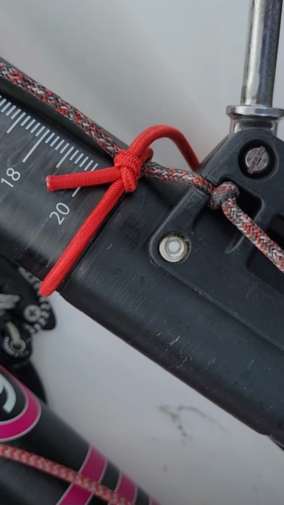

I put some tape around the line directly (not around the mast) above the not. Since I did so, I never had this issue again. Nevertheless, I agree, that the solution shown in the picture is cheap, safe and gives no real advantage. It is definitely actually not allowed, I had one and had to remove it during the measurement of the 2022 European Championship, where I got also the hint with the tape. I am not 100% sure, if this is legal, but it was never critisized sind 2022 in any measurement control.The control line in my case is a little bit thinner.

It is my understanding that, under current class rules, it is illegal to use shock cord, line or tape around the mast to keep the downhaul's knotted end in the gooseneck notch (see attached photo). A wind indicator secured above the gooseneck can also do the job.
I fail to see why this restriction exists. There is minimal cost (pennies), no performance advantage, and it makes for a much safer sailing experience (as anyone who has had the knotted end come out of the notch can attest).
I therefore would like to formally request this prohibition be removed from (or an accommodation be permitted in) the class rules ASAP.
Many thanks in advance,
Marc Jacobi, USA 3173
