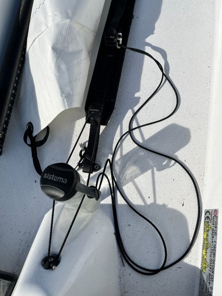

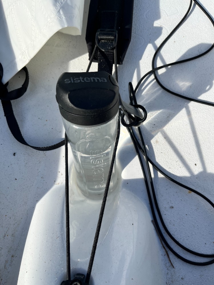

I've got a pretty long (5 feet/1.5m) bungee looped through my Sistema bottle, which is then clipped with a hook into the toe strap. The boottle is tall enough to be supported by the two bungees of the toe strap, so the bottle doesn't fall out unless I go for a swim. The bungee is long enough so I can drink without unclipping and it hasn't got into my way during racing. Obviously if I do capsize, the bottle is tethered to the boat.
Sistema sell a larger diameter bottle, which doesn't fit into the hull moulding.

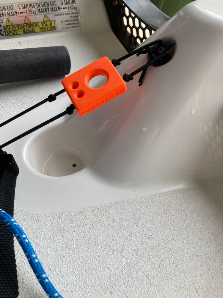

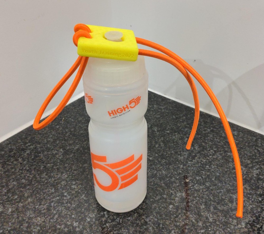

Here is my version for the 3d printed bottle holder.  The toe strap elastic is threaded through the small holes.

Hi Nick
Nice idea.  So far as I can tell from the photos and speaking to Peter, this looks like it complies with CR C.5.1 (l),
Happy sailing
David IM

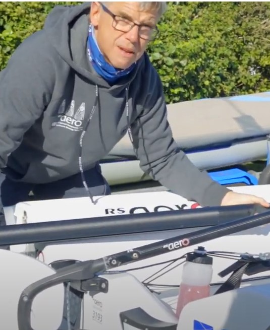

The Aero has a bottle holder moulded in the floor of the hull by the transom
The bottle will only stay in place with some assistance in the shock cord holding the toe-strap up.
Peter Barton, in his instructional videos uses a plastic ring to achieve this.
I did not have any plastic rings so i printed up a little bottle holder that serves the same purpose.
Photos to show - Peter Bartons original set-up
Bottle holder on boat
Bottle holder on bottle
Please can you confirm the legality of the arrangment
Thanks
Nick
