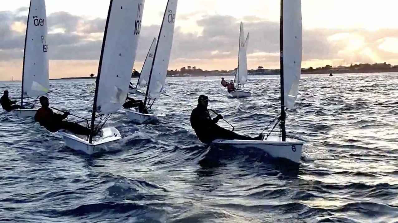

Waves Upwind
A low and fast course is better than high and slow as it keeps the boat powered in chop.
Steer the boat over the waves with body movement, weight in and aft to steer up the wave, weight out and forwards to bear away down the wave. Allow the rudder to follow the turn created by moving your weight, don’t start the turn with the rudder.
Take a look at the body movement in this video.
When overpowered tighten the kicker and downhaul but leave the outhaul off with shape in the sail to help with low down power to keep the boat moving, then play the mainsheet to keep the boat flat.
Waves Downwind
Sailing a dead run is slow due to the stalling of the mainsail. Either sail by the lee and with reverse flow or head up a little towards a broad reach.
Watch for both gusts and waves...sail to the gusts to plane, line your boat up with the wave angle to enable surfing. You are allowed 1 pump per wave (body and mainsheet together) to initiate surfing.
Ensure the kicker is released so that the leach is ‘springy’ and can ‘pant’ (not ‘braced’ tight nor ‘floppy’ slack)
Steer through the waves using some body roll to assist steering and minimise rudder drag. Keep enough centre board down to assist turning and avoiding side slip.
Move fore and aft to help the boat tip over the front of waves and not bury into the back of them.

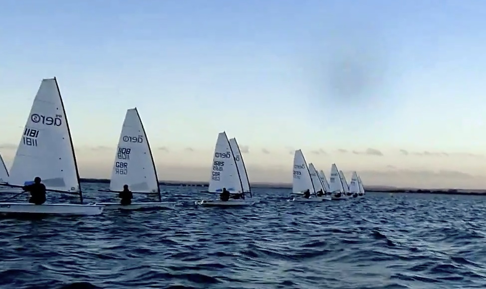

Starts
Does your starting plan include transits, line bias, course bias, favoured side & tide?
Will you start in the ideal place on the line for bias, along with the fleet, or go for a clear space for a better line exit?
Mark your plan using the following criteria:
• Did I start on-time?
• Was I on the line in the front row?
• Did I identify the bias?
• Did I select the right plan?
• Did I manage to execute my plan well? (boat handling, positioning)
• How was the initial exit from the start line? (Acceleration & lane holding)
• How well placed was I at the windward mark?
The key is to have a plan and stick to the plan unless something changes. Have in mind a Plan B if it all starts to go wrong and know when you need to go for that. For example, if you are too early or it is too crowded at the port end - you need to gybe out but not leave it too late.

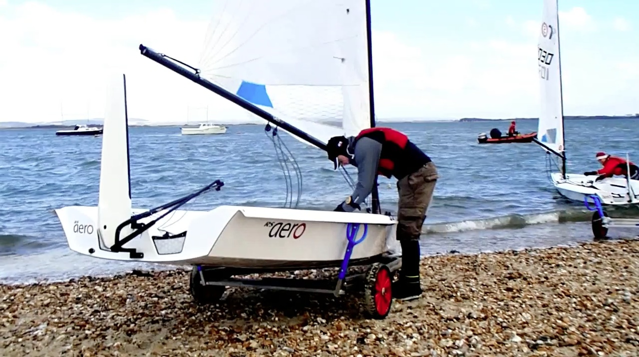

• Ensure your halyard is cleated properly at the top, and check this by tensioning the downhaul a few times ahead of launching
