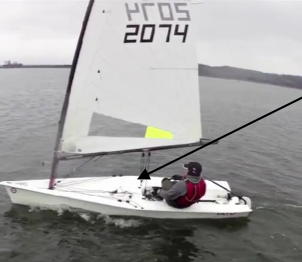

PhotoMainsheet in tight when tacking.
The tight mainsheet will keep the leach driving the boat forwards all the way until you pass head to wind, which will also aid turning. You can pull against your mainsheet hand to roll the boat.
