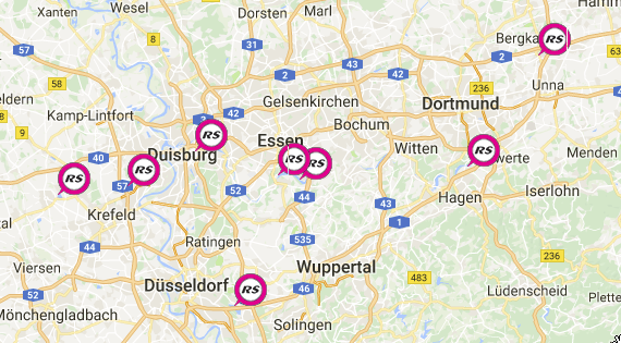

Another pin on the AeroMap, you have lots of close neighbours!
