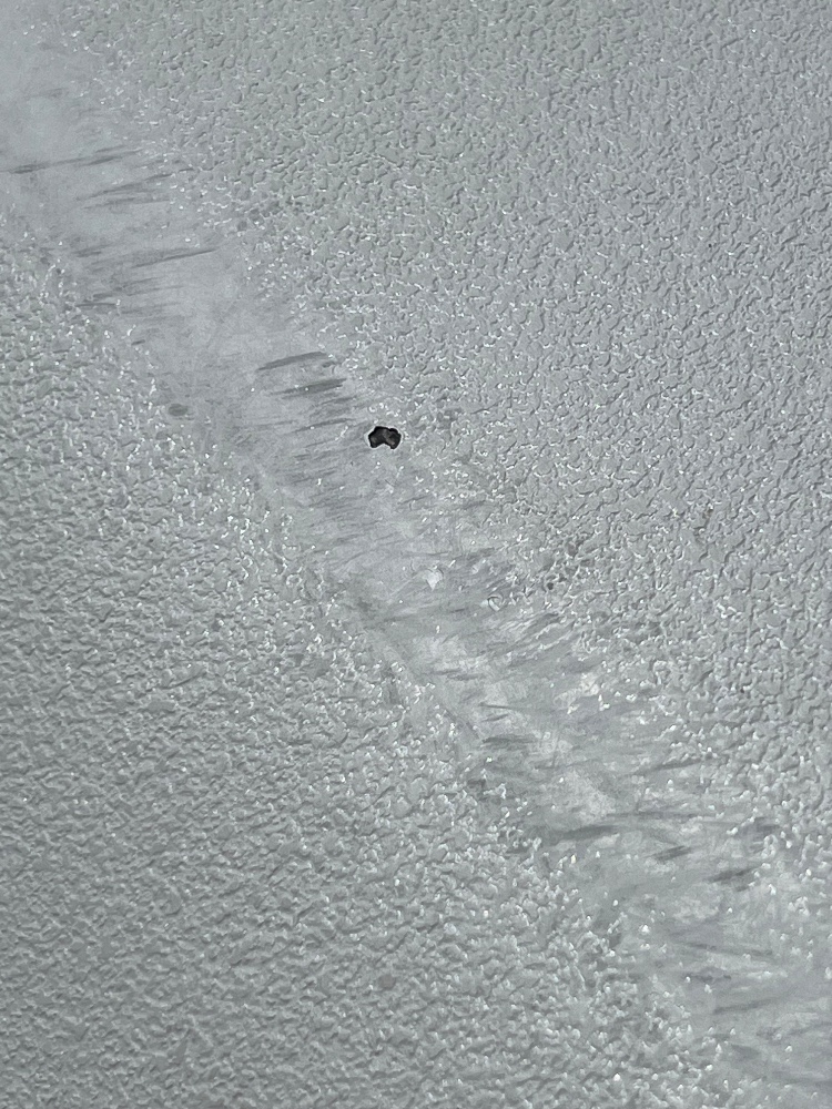

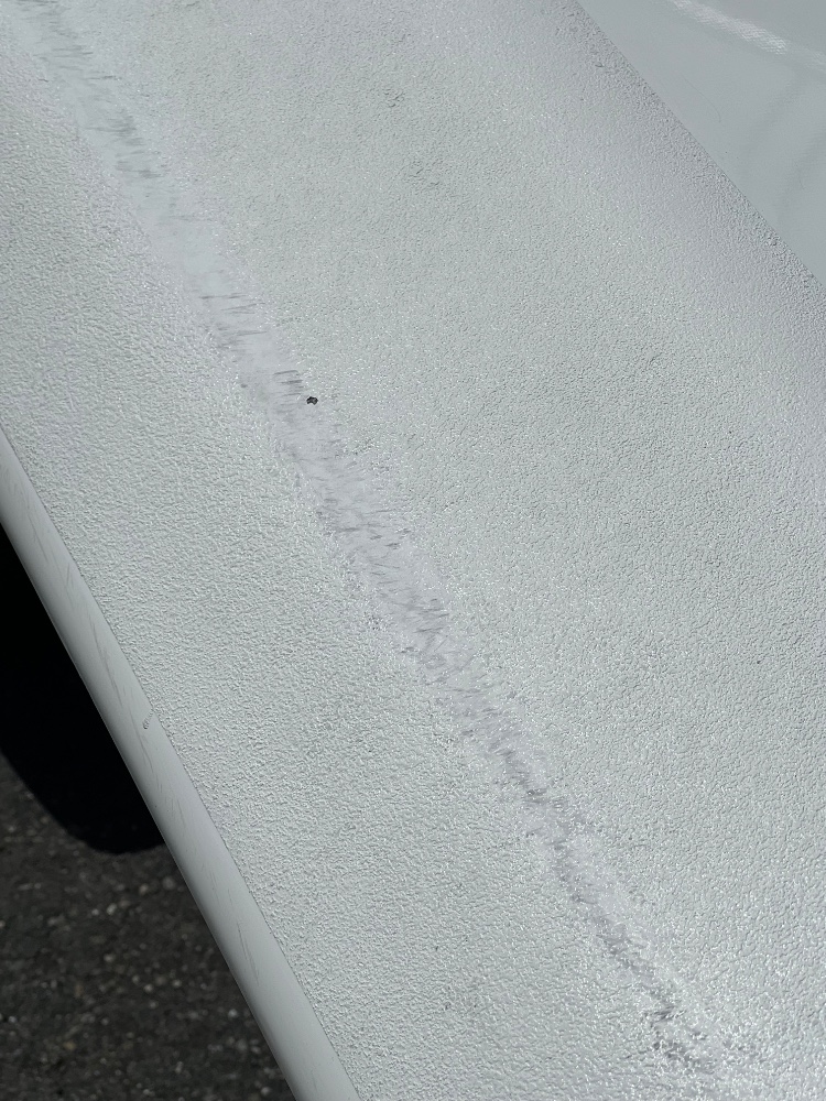

In 12 years of Aero sailing I have not seen or heard of such wear to the non-slip.
So how did this happen?
Should it be repaired?  Absolutely.
I understand the Aero deck, particularly where screws go into it, is marine ply sheathed in epoxy impregnated woven carbon fibre.
It's light & stiff, but when the skin gets punctured water can get into the marine ply, softening it.  Repair - expensive.
Screws have to have sealant around them to prevent.
The non-slip on this boat as you say is worn right down to the gel-coat, and possibly down to the carbon sheath.
There seem to be a couple of small holes, down to what?  I cannot be categoric regarding the core in this part of the boat.
Further the class rules require the non-slip to be in good order and maintained:-
Rule C.6.1.3 Modifications
    (c)  - - - 'texture must be maintained' - - 'must be reinstated' - -
Rule C.6.1.4 Maintenance
    (e)  - - - 're-application of moulded deck non-slip areas' - - -
I had my 1'st Aero 8 years and had to reinstate the non-slip.  I did think to do it myself, but was advised its a job best given to a good repairer.
I don't remember the exact cost, but it was in the 3 figures £xxx..
Given the above and the apparent very hard sailing I would also urge you to check;-
    the rudder gudgeon pins, firm or loose.  The screws go into marine ply core.
    the rudder stock to tiller joint, they can loosen and corrode from the inside.
    the tiller extension UJ.  If the tiller has been kept with the extension folded back into the bag between sailing it strains the UJ.  If the outer is splitting it's a relatively cheap part to change.

Thank you! One thing I forgot to mention, was the textured/grip gel coal on the forward outer corner hiking surface has a section 1 inch x 24 inches that is completely worn smooth and is so thin the fiberglass is visible. Port side is shown. Starboard side shows the samwe wear, but not as bad. I've never seen that before, but tells me it was sailed a lot. I assuming that needs to be repaired?

Hi all- I'm looking at buying a used Aero manufactured in 2022. It has been sailed hard in all weather conditions. Salt water. The metal fittings show some corrosion. By hard, I mean I mean is has been sailed year round and in rough weather. No damage or past repairs. Looks great. One more thing is the textured/grip gel coal on the forward outer corner hiking surface has a section 1 inch x 24 inches that is completely worn and is so thin the fiberglass is visible. Port side is shown. Starboard side shows the same wear, but not as bad. I've never seen that before, but tells me it was sailed a lot. I assuming that needs to be repaired?My question is: Is there a risk with buying an Aero that has been sailed hard? Does the hull and spars degrade over time with use?
