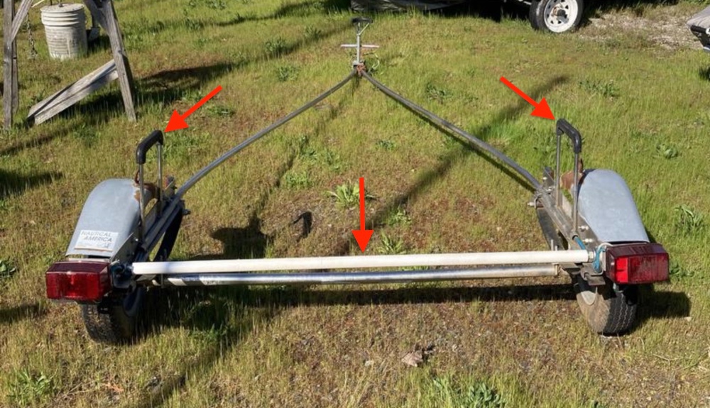

Don't have a solution, but can confirm the Aero hull is deeper and will hit the rear cross pipe.  I built some extenders to raise the height of the hull supports but then sold my trailer with my Laser and never used the extenders I built.

Hi everyone- I want to use a Laser Kitty Hawk trailer for my Aero. I was told that the Aero hull is deeper and the bottom of the hull will strike the rear cross pipe.My options are to extend the vertical gunnell rests, or bend the cross bar (pipe). I don't know the distance I would need to extend or bend the cross bar to prevent the hull from striking the cross bar. Any advice would be welcomed.
Thank you!
