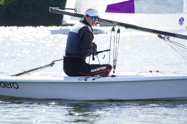

Adding a cleat which is not permitted within the Class Rules would certainly infringe the Class Rules, however it was attached.
I expect that what you can see in the photo is two clips clipping together to make the shockcord into a loop, as is specifically permitted. You can see the tale of a knot dangling.
03/10/2022 11:12:00
Posts: 5094
It is not so obvious in this scale of photograph, but if you click on the photograph to display it in a separate window it would appear that a new cleat has been fitted under the boom between the kicker and mainsheet block loops.
If fitting that cleat has involved drilling or other permanent fixing then I suspect this is outside of class rules.
CA Technical committee have final say on that aspect, of course.

If it is elastic it is in my book class legal and I have senn boats at the European passing the measurement checks with such elastic. It is only helpful for low wind conditions,

Looking at the pics from Papercourt event I see this https://www.rsaerosailing.org/index.asp?p=gallery&id=autumn-2022&yr=2022&details=5276
There is a yellow line that would appear to function to loosen the outhaul.   Is this legal & how is it rigged?
