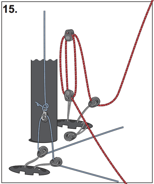

David,
I looked at several boats at the nationals and all seemed to have wear on the block. It works but it would be much better if the pulleys aligned. What is the process for getting a rule change suggestion in?
Yes it is rigged as per the diagram.  I was wondering about changing the strings that hold the pulley to try to force a better alignment but that would probably not be exactly as per diagram. The starboard side has a single pulley which aligns nicely to the rope direction but the double pulley gets twisted by the tension to align wrongly. Even in that official diagram you can see it.

Hi Gareth
Thanks for your query.  The lines and blocks must be rigged as shown in the Rigging Manual (Rule C.6.1.1), which Peter has helpfully posted in his reply.
Rule C.6.1.4 says that you can replace the double block  "using parts obtained from any supplier provided that the replacement is placed in the same position and is a like for like basis being similar size".  In otherwords it must be a double block of 18mm diam but can be from any manufacturer.
Has anyone else had a problem with undue wearing on one side of this block?
Hope this helps.  David

Gareth,
Just checking, is your downhaul rigged like this?

Posted by Gareth;
Rules question replacing blocks
Is it legal to replace the double pulley (lower part of downhaul) with two single pulleys. I see lots of wear on the port side pulley as the block never aligns properly to that side. It always aligns more to the starboard rope. Two single pulleys would align properly (no change in the purchase).
Two questions:
1. Could I use two single pulleys?
2. If no to 1. do I have to use the exact double pulley supplied or could I use one that leads the ropes in slightly better directions?
If no to either or both could I suggest the technical rep/rules folk examine this suggestion to allow in the future.

03/07/2017 10:38:16
David Rickard
Posts: 42
Hi Mike Orea
 Yes, C.9.3 requires that the vang line must be fed through the pulley in the gooseneck unless you use the extra block permitted by C.6.1.3 (p) which permits the vang line to be led through a pulley not exceeding 20mm diam tied around and hung next to the gooseneck pulley.
David

02/07/2017 18:03:58
Mike0rea
Posts: 30
Correct the spelling of manuel Manual, see (b)(i). Also I take this to mean the kicker must be fed via the pulley in the gooseneck, although an external pulley may be attached to it , provided the diameter does not exceed  20 mm.
pastingC.9.3 RUNNING RIGGING
(a) MODIFICATIONS, MAINTENANCE AND REPAIR
The total purchase ratio in each of the control line systems shall not exceed: vang –16:1, cunningham – 8:1 outhaul – 4:1. The mainsheet shall be uniform diameter throughout its length. The traveller shall be a single non-tapered line which will allow the traveller block to move from one side to the other. The traveller rope shall not extend more than 250mm above the deck at its highest part.
(b) USE
(i) Save as permitted in C.6.1.3, running rigging shall be led through and attached to the fittings supplied for the function as shown in the Rigging Manuel.
(ii) The crew may control the mainsheet from any of the turning blocks in the mainsheet system.
